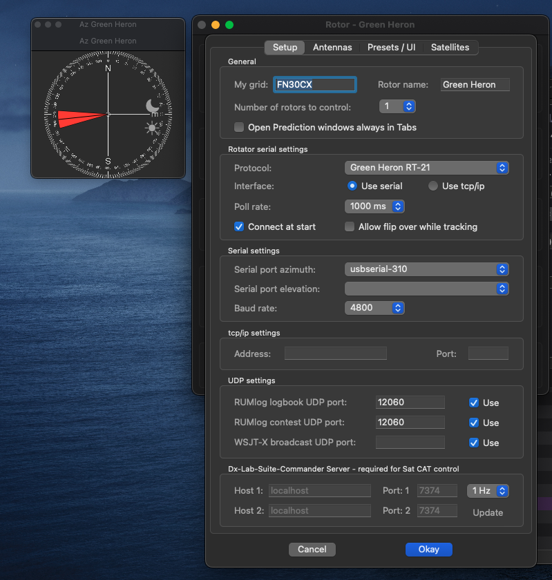

K2MIT
Joined: Mon 23. Oct 2023, 18:31
Re: Auto Rotate
Unread post by K2MIT »
I hope this is the screen you want. I used the attachment feature.
Thank you for your help.

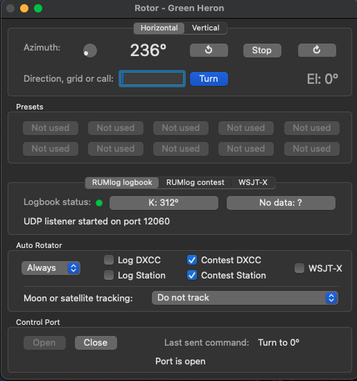

And for the control window?
K2MIT
Re: Auto Rotate
Sorry, that is window-Control Window 1 from the Rotor program. What other window did you mean when you said "control window?"

No, this is a preferences window. Close this one. It seems to be named Rotor - Green Heron.
K2MIT
Re: Auto Rotate
Ahh...This one. This is the correct rotor position. It is seeing the Green Heron controller.

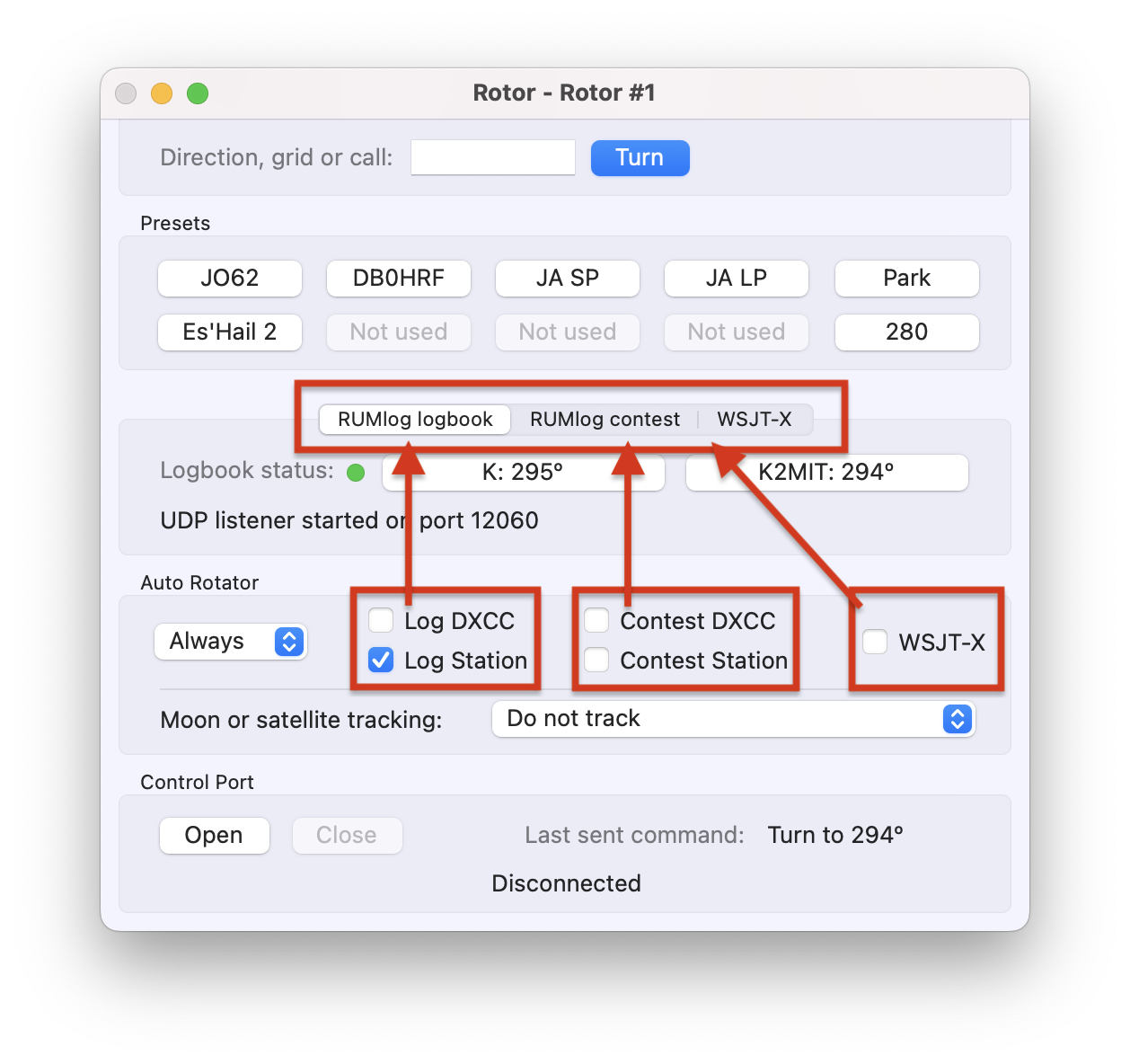

Re: Auto Rotate
  • Do not use the same port number for contest and logbook, the app doesn't know what is to do when receiving alternating commands.
  • There is no port given for WSJT-X. Deactivate this option in the Preferences.
  • In your screen shot you want to follow th logbook, but you haven't given an option. DXCC or Station?
  • You want to follow the Contest, but you have choosen Logbook from the tab bar
