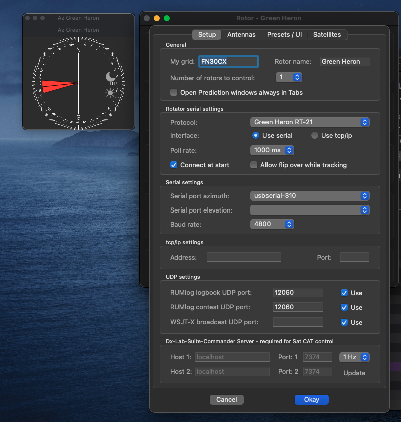

I hope this is the screen you want. I used the attachment feature.
Thank you for your help.

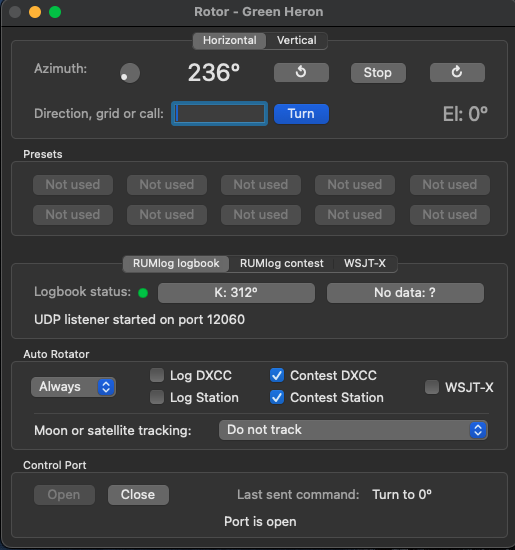

Ahh...This one. This is the correct rotor position. It is seeing the Green Heron controller.

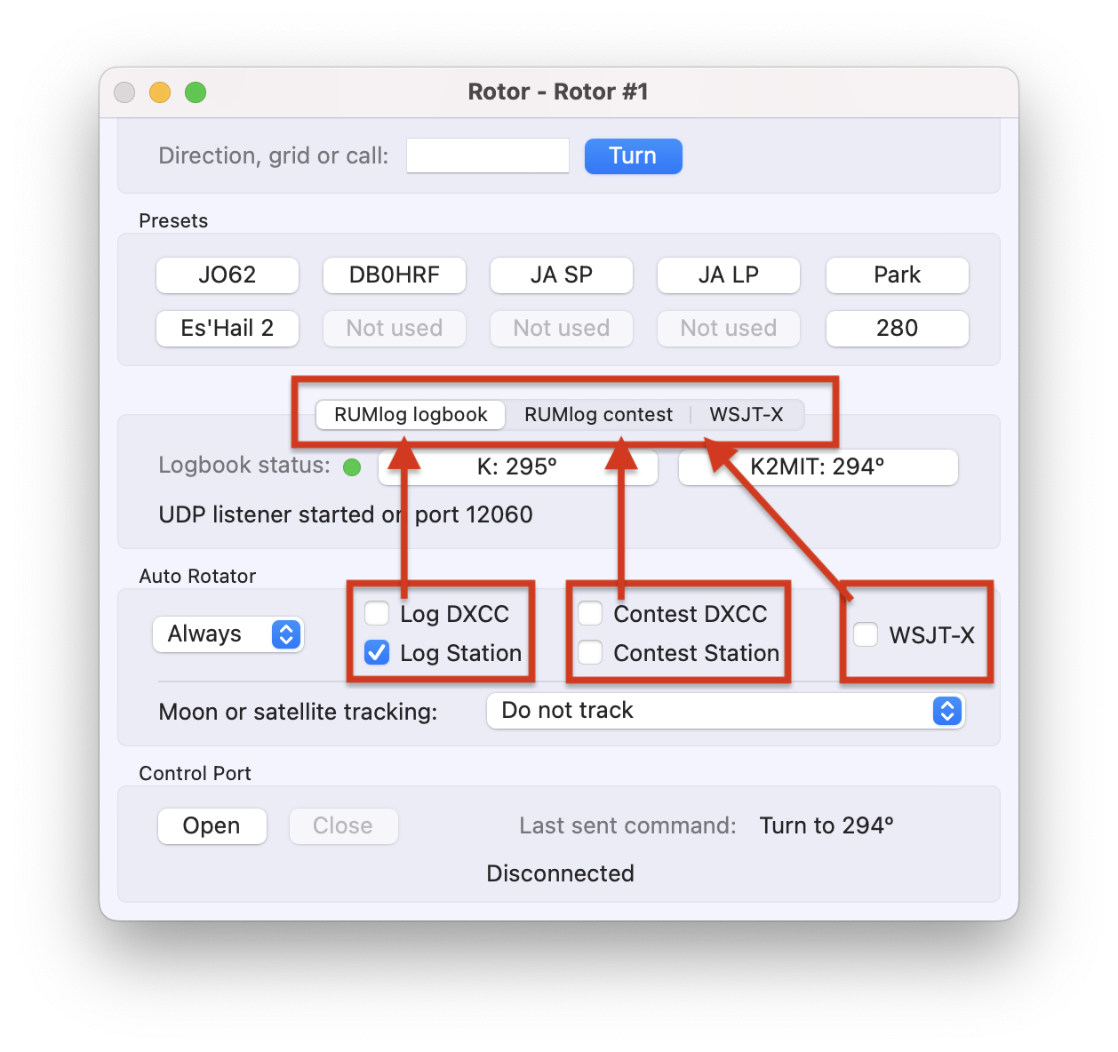

  • Do not use the same port number for contest and logbook, the app doesn't know what is to do when receiving alternating commands.
  • There is no port given for WSJT-X. Deactivate this option in the Preferences.
  • In your screen shot you want to follow th logbook, but you haven't given an option. DXCC or Station?
  • You want to follow the Contest, but you have choosen Logbook from the tab bar
