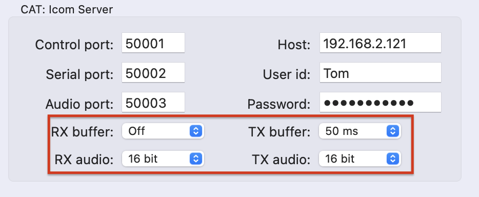

I only have to adjust the TX level, even with TX power far below 100% output I can still see other spikes to the right and left of the TX signal (on the scope display IC-7610). This is not the case with USB.

Make sure you have set Audio to 16 bit.

I found no option to set audio to 16bit on Macbook Air 2025 ?
Posts: 2994
Re: RumlogNG and WSJT-X TCPIP IC-7610 setup audio ?
In the TRX Preferences

ok thanks :-)
