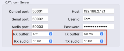

Make sure you have set Audio to 16 bit.

I found no option to set audio to 16bit on Macbook Air 2025 ?
Posts: 2946
Re: RumlogNG and WSJT-X TCPIP IC-7610 setup audio ?
In the TRX Preferences
