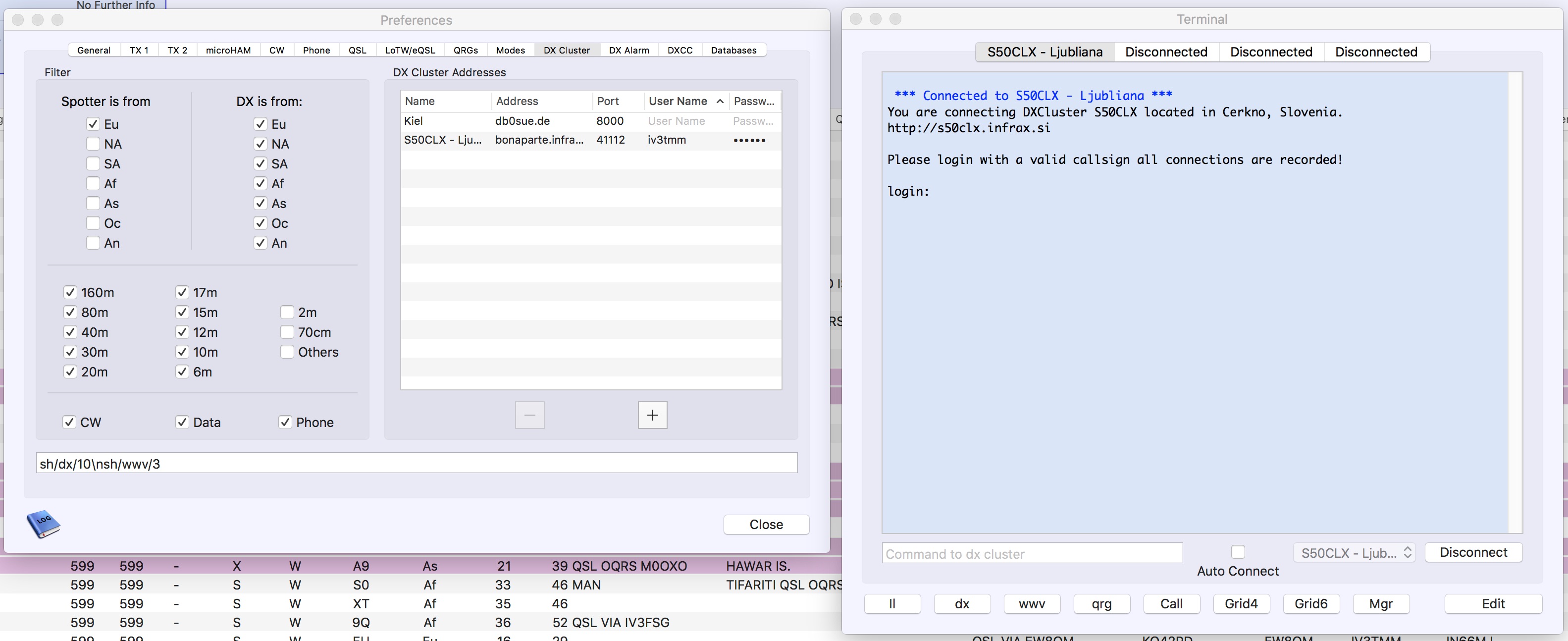

1) Can' t login automatically on my DXCLuster S50CLX. After connection cluster is waiting for my callsign after the word "login:" (Picture_1)

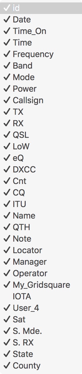

2) In database, the field "id" appear and disappear in random mode, even if it is selected (Picture_2 and Picture_3)

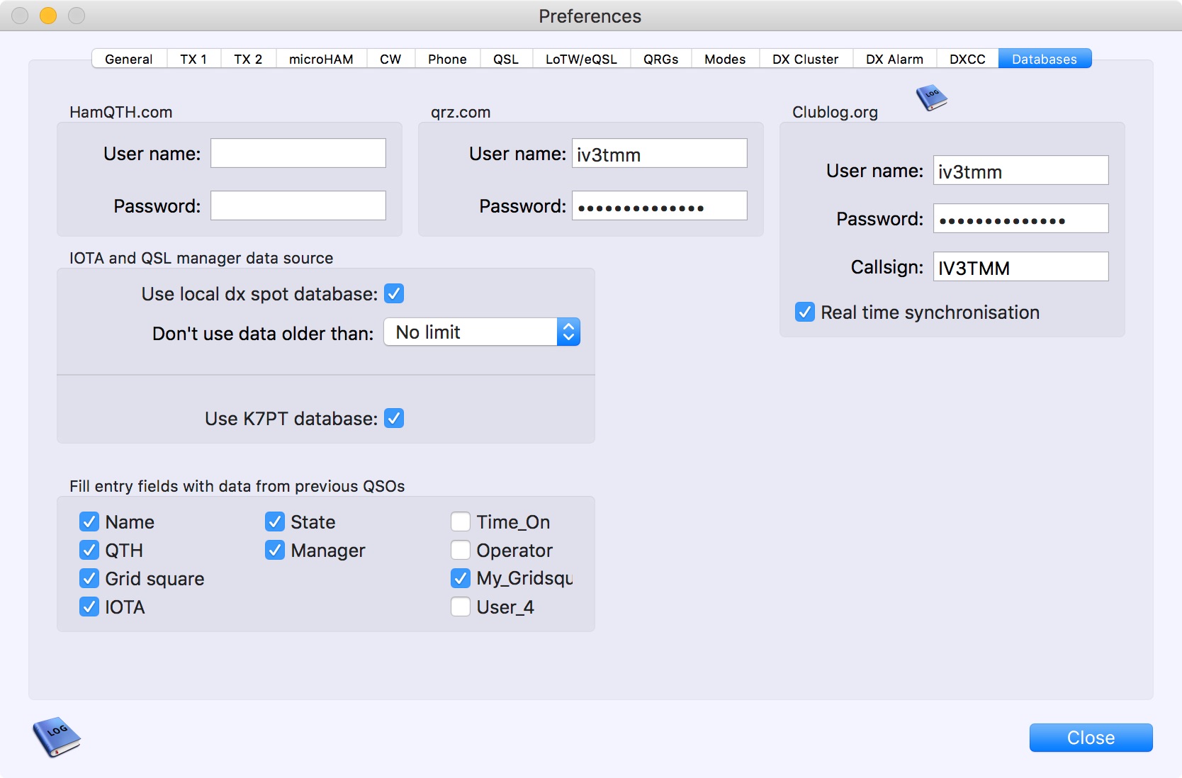

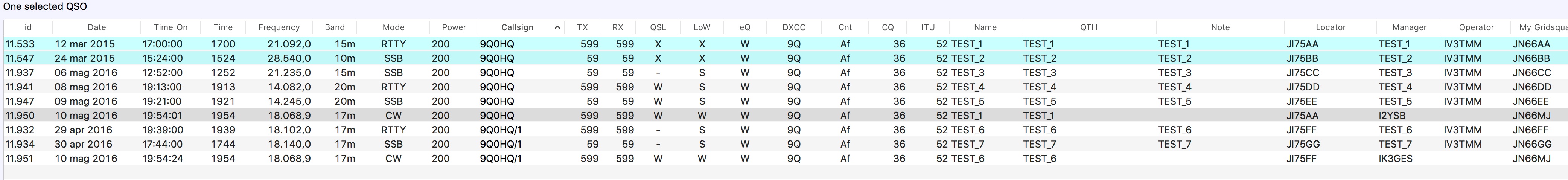

3) In database, when i input a qso, the fields NAME, QTH, NOTE, LOCATOR, MANAGER and OPERATOR are not copied from the previous qso but from the first qso. Some fields are not copied or populate like NOTE and OPERATOR even if
thery are selected to be copied from previous qso (Picture_4, Picture_5 and Picture_6).
I done an example. Starting with records 15533-11547-11937-11941-11947-11932-11934 i inserted then records 11950 and 11951. You can see which fields has been copied or not copied and from where
4) Field OPERATOR and USER_4 can not be checked (Picture_4)

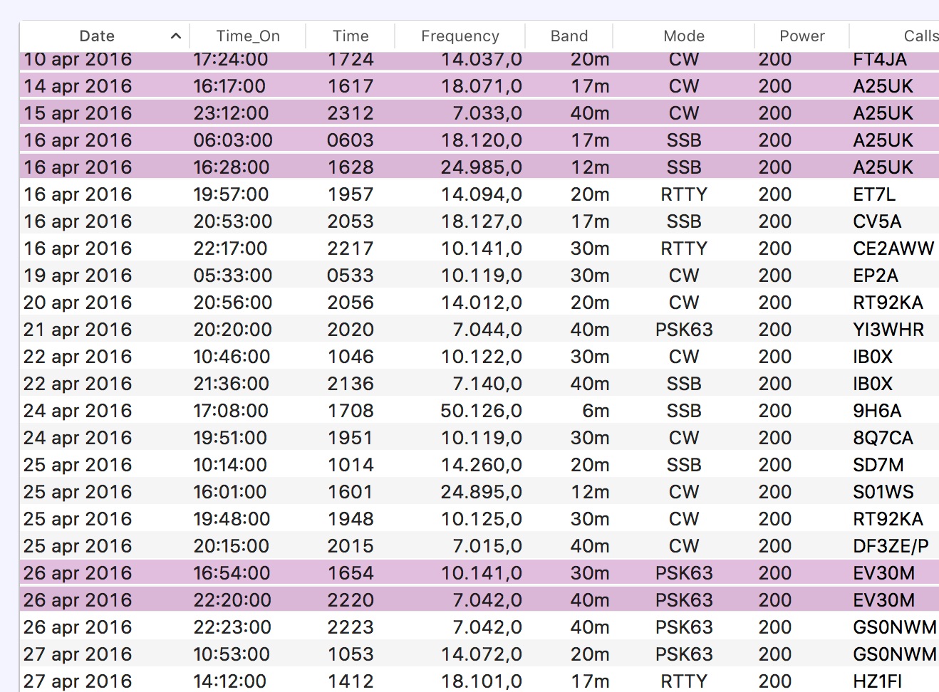

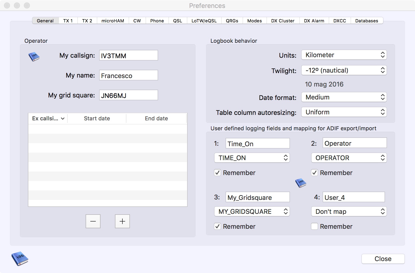

6) It' s possible to have the field TIME in format HH:MM ? I create one of the four field with the ADIF TIME_ON (Picture_4), and this is in HH:MM:SS format. Two formats for the field TIME, may we have a unique format ?
Could you give the possibility to select which format time we want under settings-preferences like the data format ? This will be fine. Personally i' m not interested in seconds, only hour and minutes.
Here it works, but maybe I'm using another address? I use s50clx.infrax.si
This field is not for general use. Somebody wanted to have some kind of numbering, so it appears in the main logging table only.
Fixed.
Fixed.
