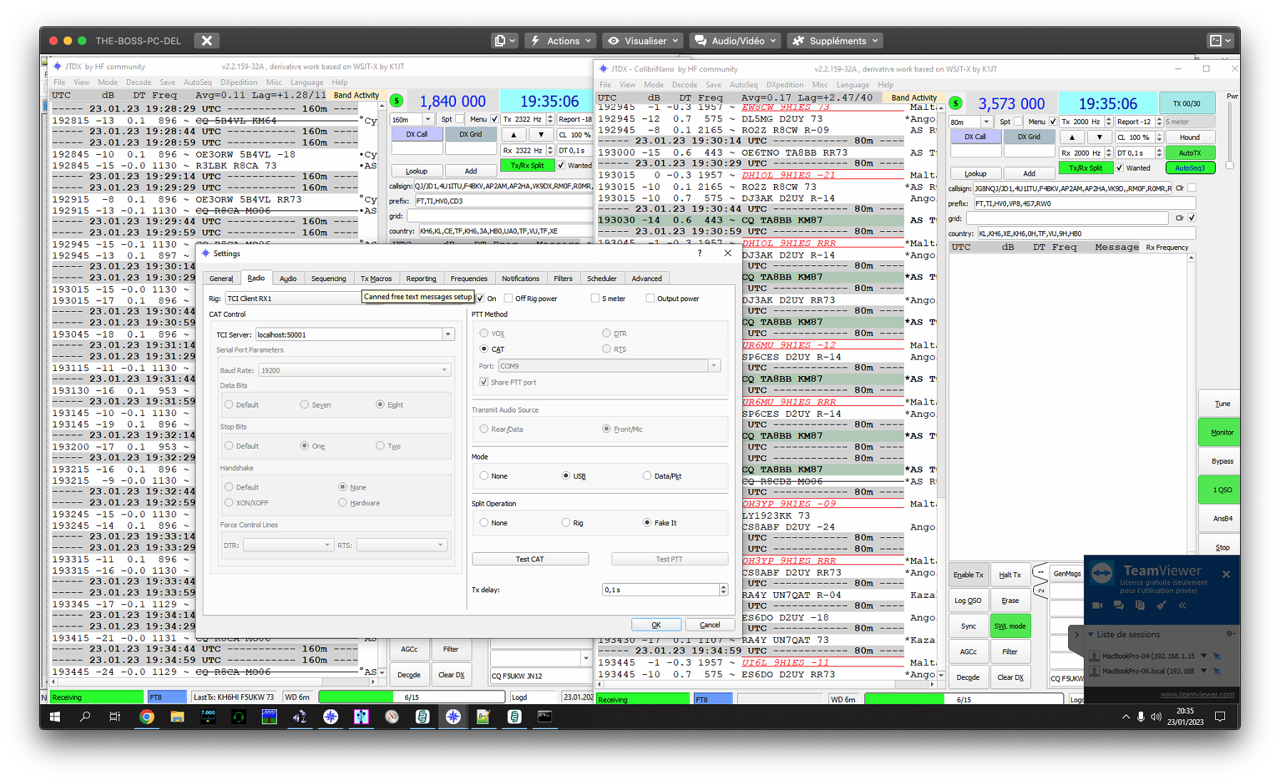

I'm trying to control JTDX from RUMlogNG, which means, when I ask him to QSY I was hoping JTDX Would do it as well :D
I tried to follow this procedure: https://dl2rum.de/RUMlogNG/docs/en/pages/WSJT.html but documentation is probably a bit outdated.
Sending QSO from JTDX to RUMlogNG was easy, trying to control JTDX from RUMlogNG is still a challenge.
Thanks for your help
Attachement may help to understand my issue, and what I'm doing wrong

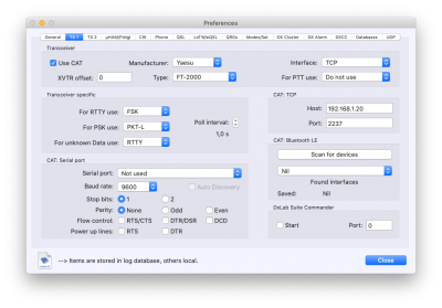

CAT TCP setting
CAT TCP setting

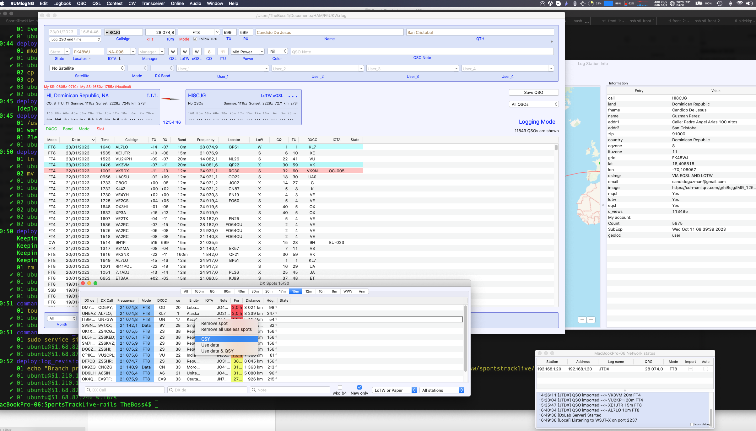

Trying to QSY from RUMlogNG but nothing happen
Setting on 192.168.1.20 on JTDX

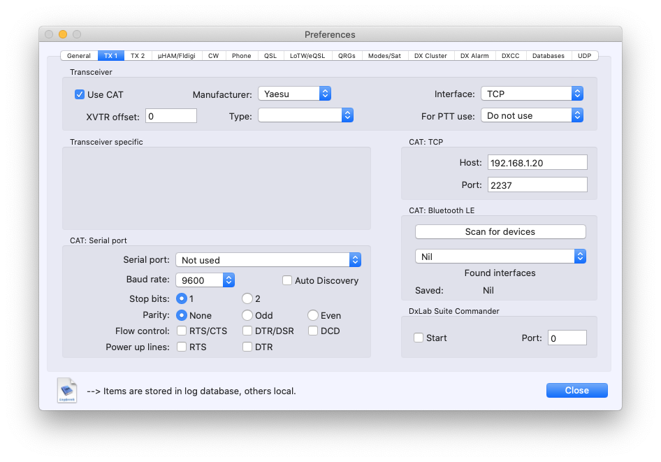

RUMlog doesn't have any CAT control in your setup! You haven't selected any transceiver model.
  1. Get CAT control working
  2. Connect external apps to RUMlog

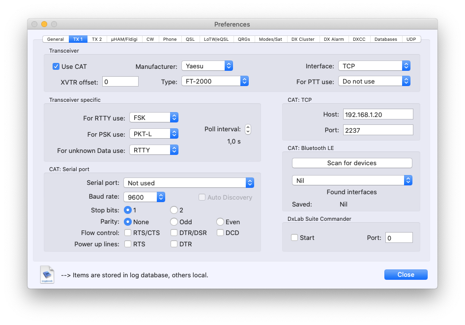

sorry you mean setting TX like this?
What do you mean "Connect external apps to RUMlog"?
Posts: 3101
Re: Trying to let RUMlogNg to QSY and control JTDX
The best approach is to let RUMlog do the CAT control. Other apps control the trx via RUMlog.
Can you control your trx via network as selected?

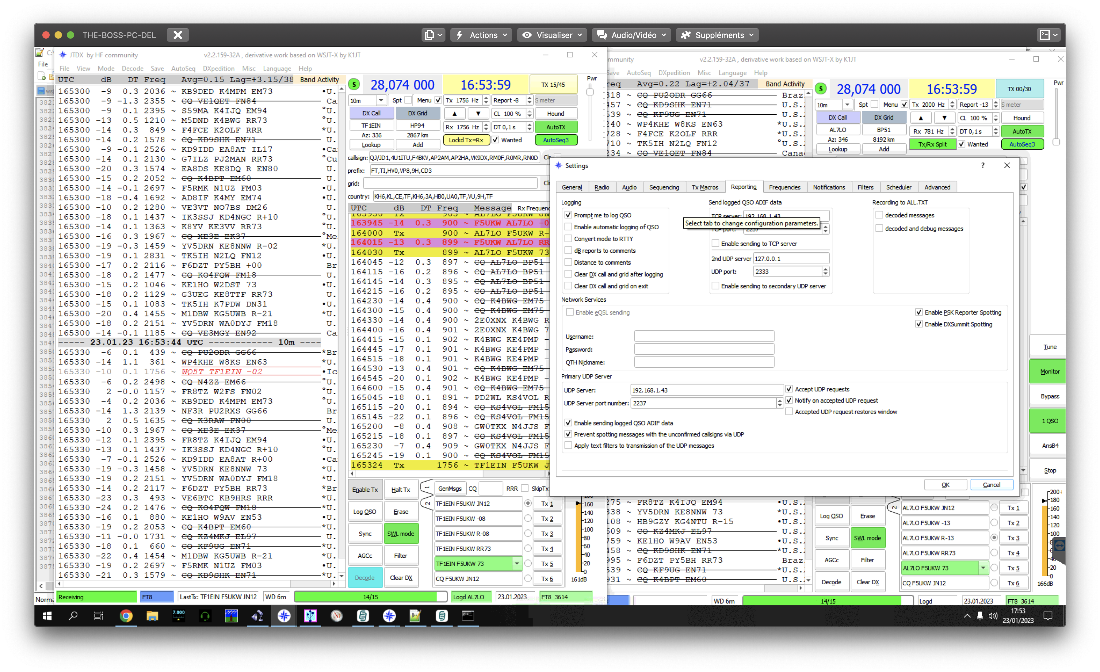

WSJT-X/JTDX are supporting nicely TCI
I'm using it with ExpertSDR3 and FT2000
