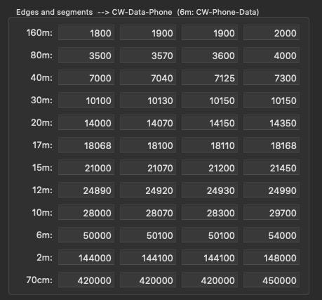

Wire shark shows UDP packets from JTDX with the correct information for all bands.
Rumlog does not populate the DX spots windows if the frequency is 10,136.00 MHz (30m)

Do you have assigned this frequency to the Data sub band in the QRG preferences?
