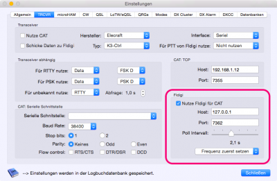

Can you try to connect the TRX to Fldigi? You have to swap both Fldigi related CAT check boxes

DL2RUM wrote:Can you try to connect the TRX to Fldigi? You have to swap both Fldigi related CAT check boxes
What is odd is that with RUMlog fldigi follows the VFO. This only happens with RUMlogNG. :(

What happens, when you disable all the TRX CAT and uses Fldigi for CAT? You don't to set up Fldigi for CAT, frequency exchange should work in both directions.

This did not work with RUMlogNG. I am out of ideas :(

Don't hate me for this but I moved RUMlogNG and Fldigi to a different computer and all is working perfectly. New computer is running 10.10.x where old computer is running 10.9.x.
Go figure. Thank you for the rapid response and guidance.
