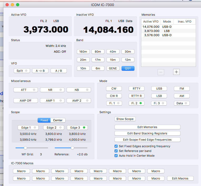

In RumLogNG IC-7300 control I have checked "Set fixed edges according frequency"
My band edges are:
3.5 to 3.599
3.6 to 3.799
3.8 to 4.0
When I have the "Set fixed edges according to frequency" checked it automatically jumps to Edge 3. My radio freq. is set to 3.576, but it still jumps to Edge 3. If I click on Band Edge 1 it'll automatically jump to Band Edge 3, even when my radio frequency is 3.576. It stays on Band Edge 3.
I cannot get it to work when tuning up and down the band.The band edges do not change as I'm tuning.

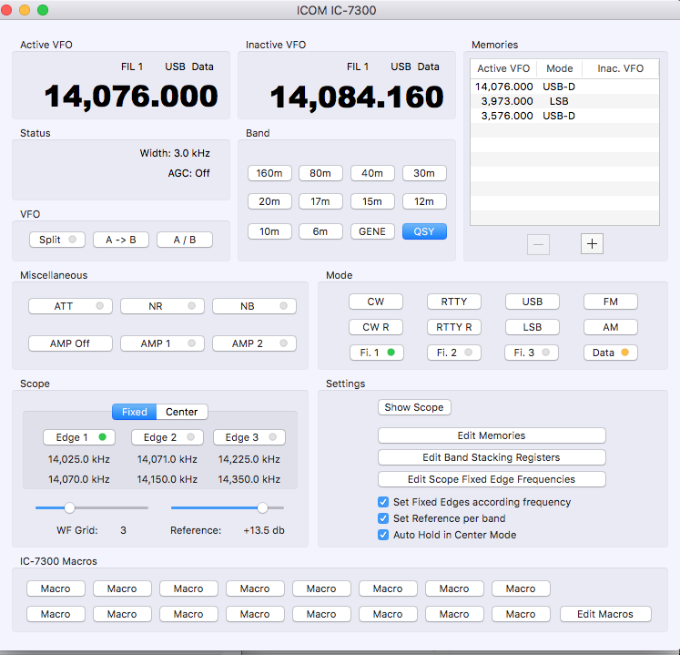

My band edges are:
14.025 to 14.070
14.071 to 14.150
14.225 to 14.350
On 20 Meters I can use the IC-7300 control to switch between band edges (unlike when I'm on 80 meters), however it still does not change band edges. I tune up and down the band and the screen does not change band edges.

Do the read outs below the Edge buttons show the correct selected values?
A screen shot of your settings would be helpful.
A highlighted button in macOS means always, that this is the currently default button. Just hit the Enter key to perform its action.

Yes, it looks like eveything is correct.

Seems to be a problem with the number format. Please check this and report:http://dl2rum.de/RUMlogNG/RUMlogNG_Test.zip

Oh man that's perfect. I think its all good now. Thank you!
