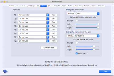

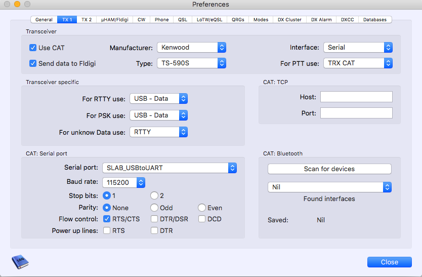

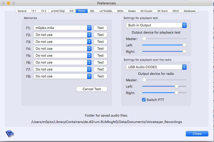

In my case when I pressing F1 nothing happens.
Screenshot attached. Cant get working...
What i'm doing wrong?
Regards, Kes.

Unread post by m0pkz »
It's works now, but only when going to menu CW / Memory 1 and pressing with a mouse...
When pressing on keyboard F1 nothing.
But actually sound goes on air.!!!!!!!
Posts: 2952
Re: Voice Keyer on TS-590S No audio
Kes, when F1 don't work, make sure the log window has the focus and you don't have assigned another function to the F keys in the system preferences.
