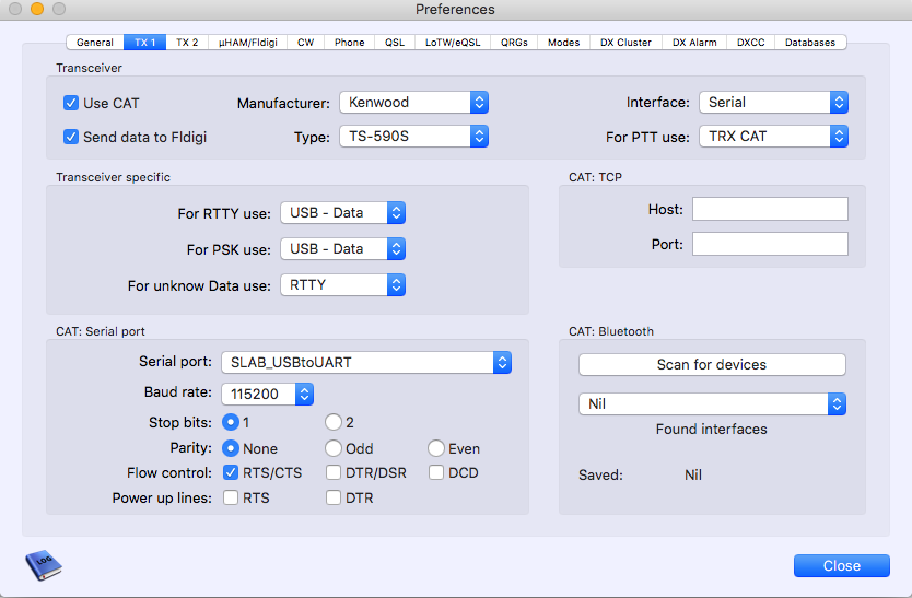

In my case when I pressing F1 nothing happens.
Screenshot attached. Cant get working...
What i'm doing wrong?
Regards, Kes.
Regards, Kes.

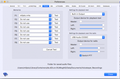

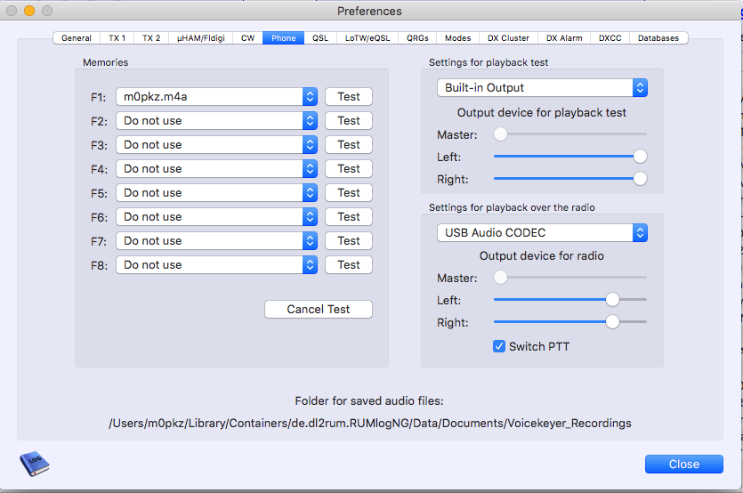

Re: Voice Keyer on TS-590S No audio
It's works now, but only when going to menu CW / Memory 1 and pressing with a mouse...
When pressing on keyboard F1 nothing.
But actually sound goes on air.!!!!!!!
Kes, when F1 don't work, make sure the log window has the focus and you don't have assigned another function to the F keys in the system preferences.
Ye founded ...F1 used different app.
Thank you Tom!!!!
Thank you Tom!!!!
