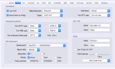

I have the Hamlib screen unchecked. I do have the xlm screen checked.
I am uploading a screen shot of my settings.
Michael

I'm sorry. I' don't understand what you mean with "When I change the screen on FLDIGI using the Book"
Maybe there is a misunderstanding on your side. With your setting, you can't control the trx from fldigi. Fldigi will just show always the mode and frequency from the trx.
