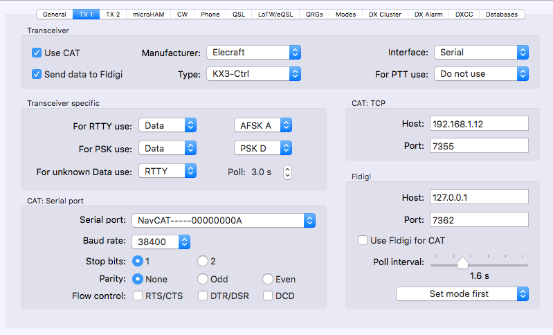

I am running El Capitan on a MacMini. Timewave Navigator and Elecraft KX3, with Fldigi 3.23.09 or 3.23.12.
When I change the screen on FLDIGI using the Book, FLDIGI will go to that frequency, but, the radio does not move. Then after about 3 seconds the FLDIGI screen goes back to the original frequency.
I have the Hamlib screen unchecked. I do have the xlm screen checked.
I am uploading a screen shot of my settings.
Michael
Posts: 3108
Re: FLDIGI 3.23.12 and Rumlog
I'm sorry. I' don't understand what you mean with "When I change the screen on FLDIGI using the Book"
Maybe there is a misunderstanding on your side. With your setting, you can't control the trx from fldigi. Fldigi will just show always the mode and frequency from the trx.
