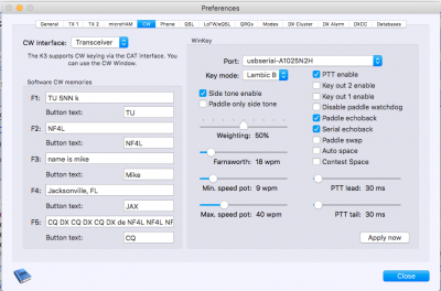

I'm trying to get Winkeyer (a kit I just finished) working with NG and an ICOM PRO II. The CW key window says there is no CW interface. Running on a MacBook Pro OS X 10.11, USB/serial adapter to the keyer. It works on Windows (Parallels) on the same machine and cable.

If you want to use the Winkeyer, you have to select it from the "CW Interface" pop up menu in the CW preferences.

NG now recognizes the keyer, but still doesn't key the rig. Is there some other setting I'm missing?

You have to select at least one key output.

Thanks Tom! Key out 1 did it.
