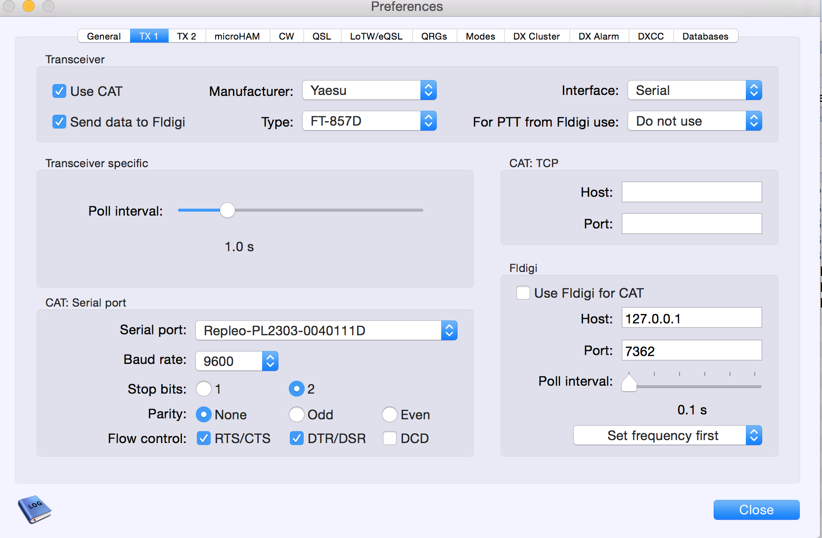

I have been testing the integration with FLDIGI and got few troubles (attached print screen configuration TRX1):
1.- When FLDIGI is open, I can not change the frequency from RM using DX Spot window. It is like FLDIGI is controlling the CAT even if I check the box "Use CAT" in TRX1.
2.- If I check "Use CAT" and "Send data to FLDIGI", if I double click in DX Spot Window, the frequency in Main Log Window is not the spot but the FLDIGI frequency (I am sorry but it seems that I only can upload one file per discussion). The frequency that I double click in RM is not sent to FLDIGI even if I check "Send Data to FLDIGI"
3.- If I close FLDIGI and reset #CAT1, everything comes to the normal behaviour (RM controls the RIG) only if I uncheck "Send data to FLDIGI", otherwise it still does not control de RIG.

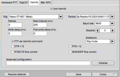

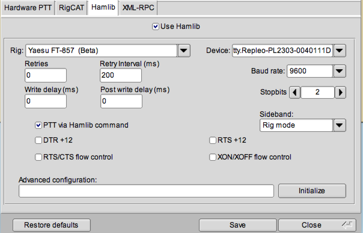

I have not enabled xml-rpc but hamlib (attached configuration). I am going to test it. Should I only unmark HAMLIB and mark xml-rpc? without any additional information about serial ports? or do they come from RM?

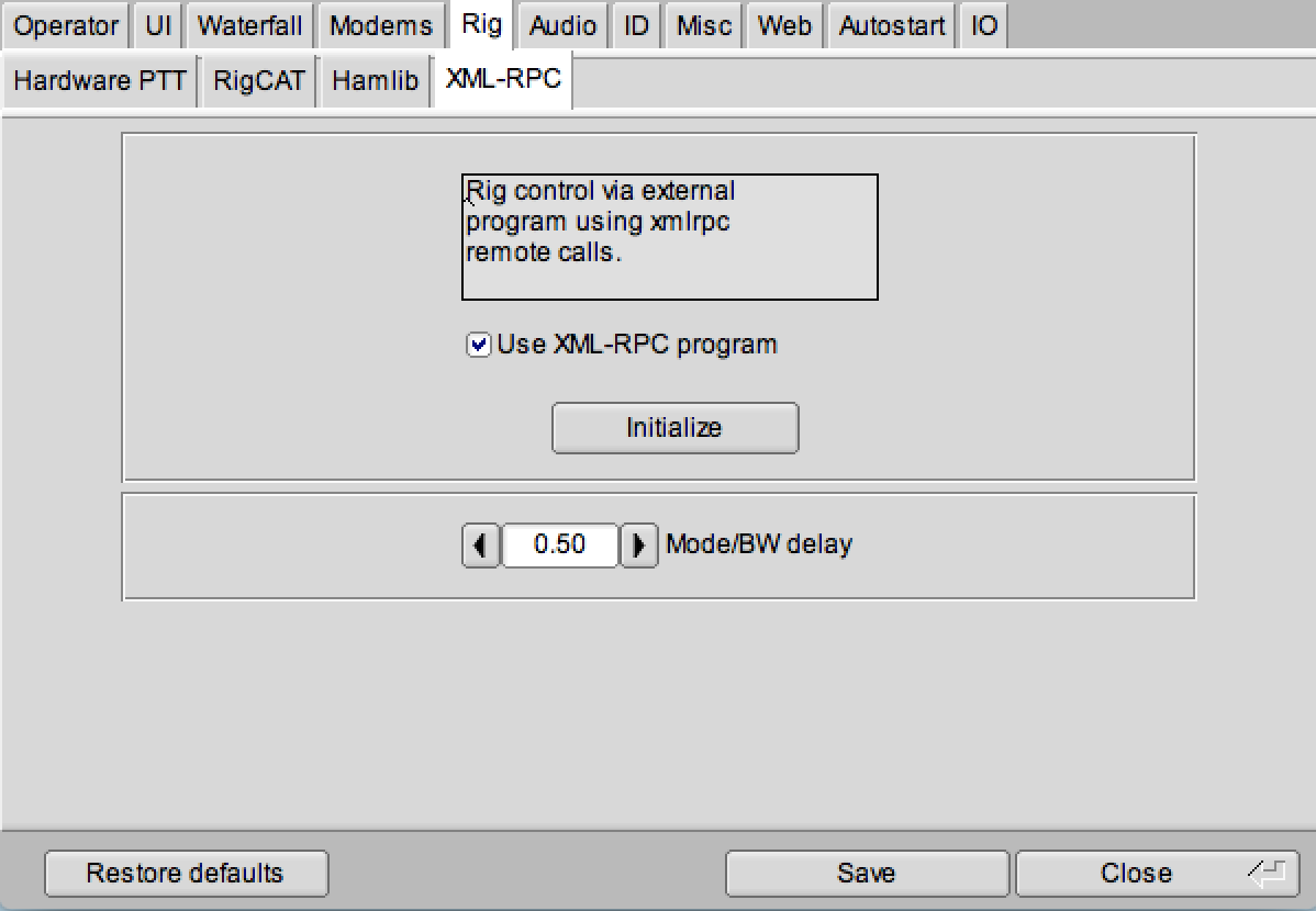

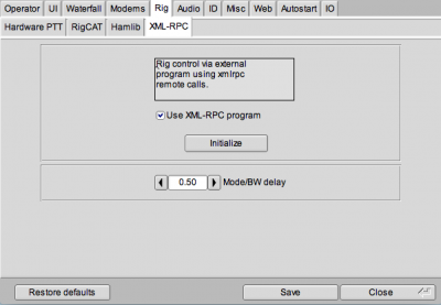

Cool, worked it out!
I removed the HamLib check and mark the xml-rpc and check "Send data to FLDIGI". Reinitialize #CAT1 and now RM is the one that controls fldigi....

Once again: Only one application can control your radio! When you have to connected it to RUMlog, RUMlog has to switch the PTT for Fldigi. See this option in the TRX settings.

Yes I know, only one can control the CAT
I am sorry, I forgot to check the part of the manual for
"For PTT from Fldigi use"
-->If RUMlog has CAT control, Fldigi can command RUMlog to switch the PTT. Enter xml rpc control address and port in the Fldigi section!<--
Now works fine, thanks and my apologies for not paying attention to this sentence in the manual.
