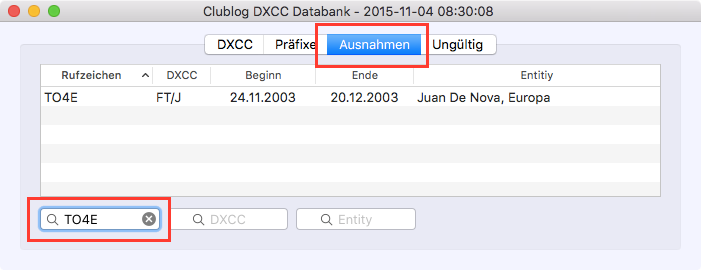

  • Go to Menu-->Online-->Show DXCC Database
  • Go to the Exception tab
  • Enter the callsign in question into the Callsign search field
  • Check if the QSO date is in the given range
When it is okay just double click the QSO in question in the log table to bring it into the QSO Edit Mode. After pressing "Save", it should show the correct information.

All QSO's were in date range. Double clicking them and saving corrected them.
