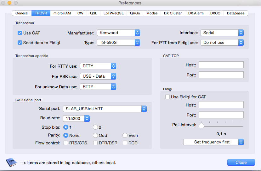

Is the frequency readout correct? Can you control the TRX from the Mac?
Please post a screen shot of your TRX settings.
yes, the rtx is controlled without any problem from the mac.
with "settings" you mean this?

Posts: 2995
Re: Small issue
As far as I know, the TS-590 uses RTS/CTS for flow control. Make sure, the setting matches the setting in your transceiver (if applicable)
