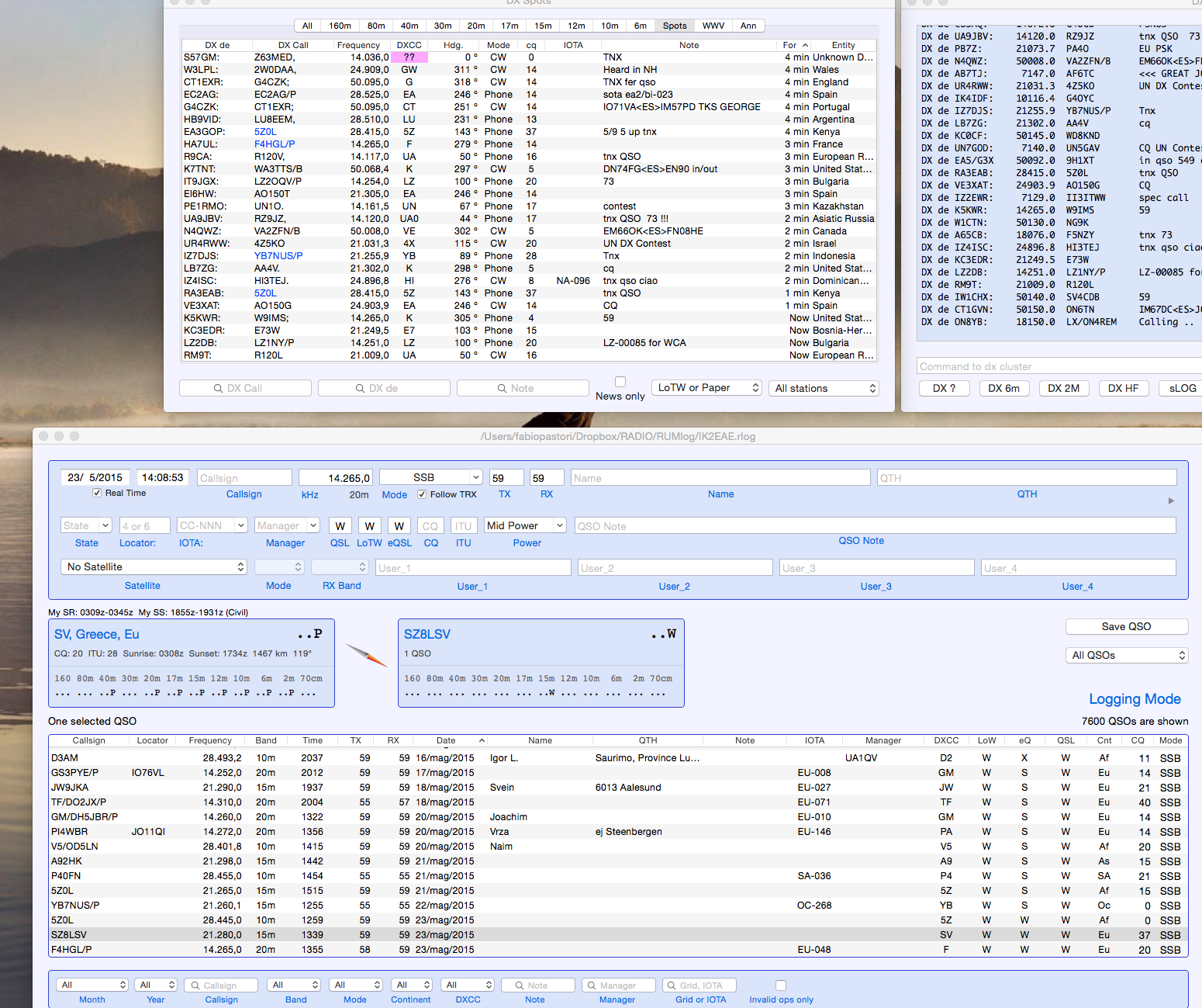

With the last version (1.2) if I pick up a call spottted from DX SPOTS windows (cmd+D) with a double click, the CQ zone is saved with a wrong number.
I had F4... zone 20, SV zone 37, 5Z0L zone 0.
On DX SPOTS the zone displayed is correct.
On country status window are displayed correct (France 14, Greece 20 etc.) and if I write manually the callsign the CQ zone are right.

Opps - Tnx for pointing out that. It seems it shows always the zones from the double click before. As workaround, clear the fields (cmd W) before you double click a spot. Or you can double click a spot twice.

Right! it take the cq zone from prevoius QSO, I don't know why zone 0 for 5Z...
I have downloaded the new version from the link on this forum and of course the map don't work, but I didn't found the new version on apple store.
There's still 1.1.
