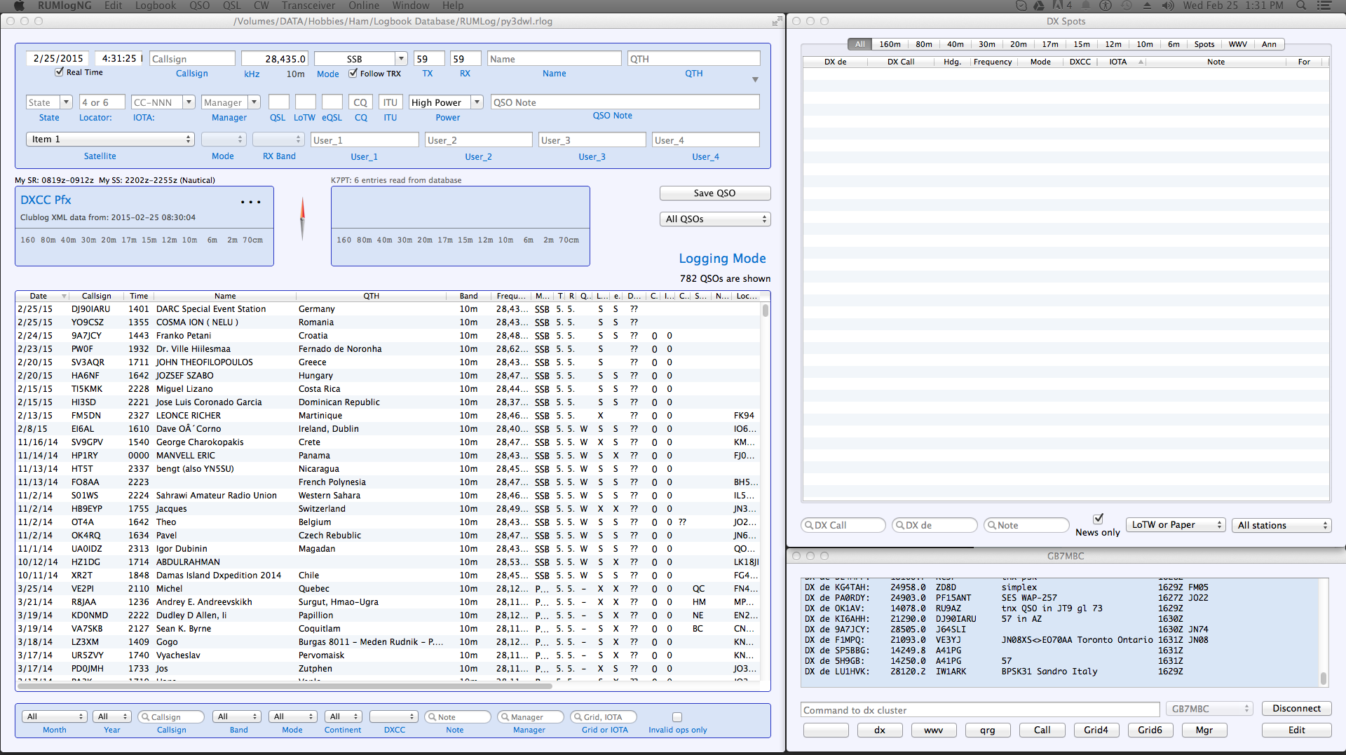

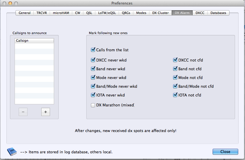

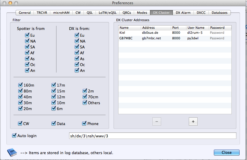

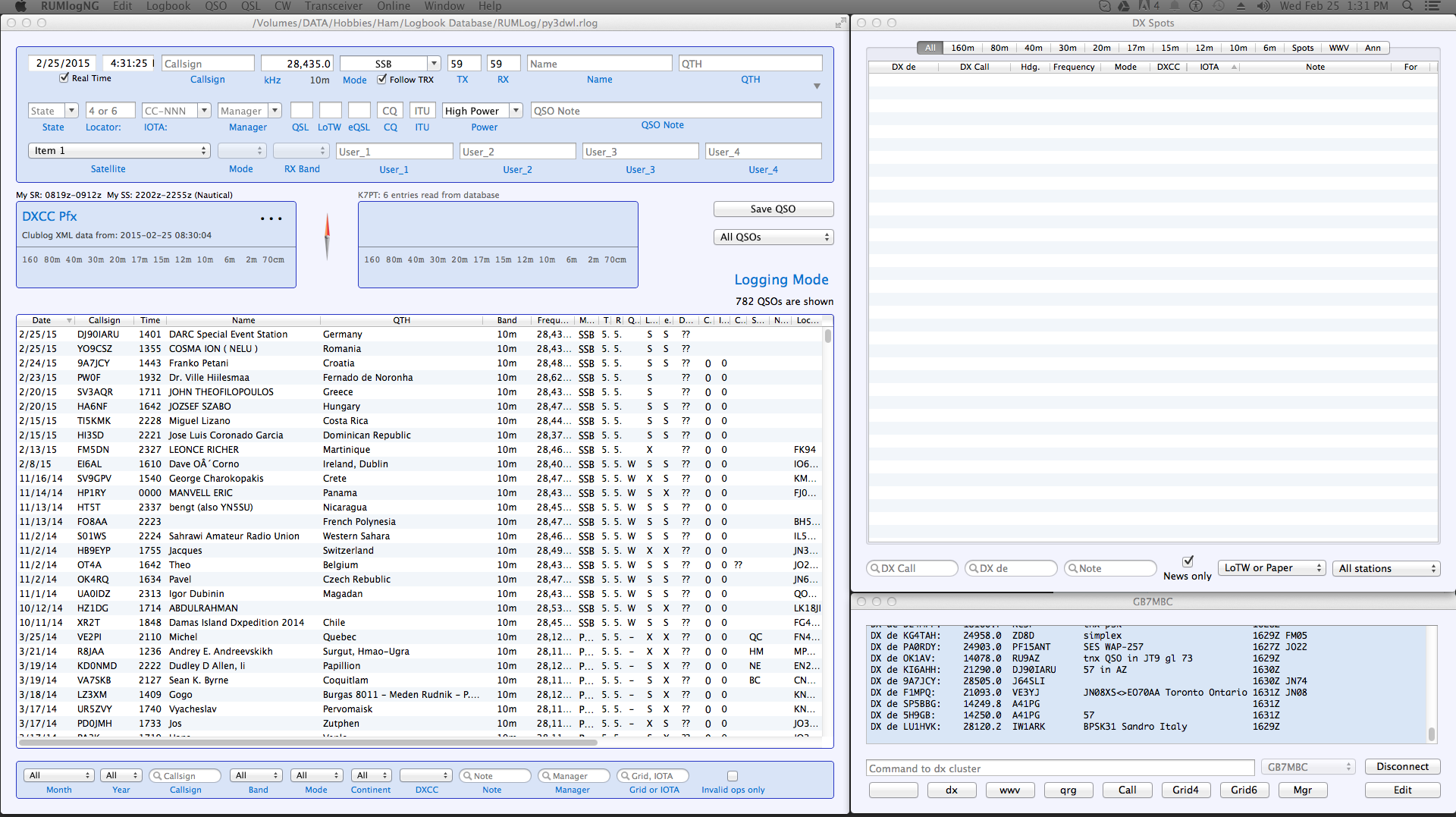

Please post a screen shot of your "DX-Cluster" and "DX-Alarm" settings and from the dx-spot window.

Here´s the screen shots you ask for.
If I disable "News Only" nothing happens also.
Thanks.

Your settings are looking good, using exactly the same works fine here. Please let the option "News only" unchecked for testing.
I have to investigate further more.
