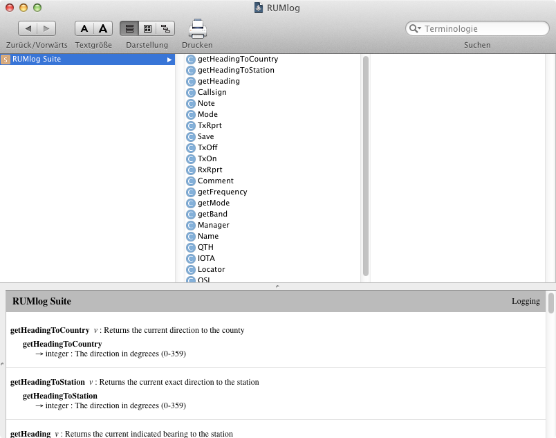

You can use the AppleScript-Editor to get more information:
What are your intentions? There is a direct import routine for fldigi files in RUMlog.

I know there is an import function and a log scanning function. For me the log scan takes too long, over 10,000 QSOs in my log. The import function works but it is a little cumbersome having to close telnet windows first. I was going to attempt using the info at http://www.w1hkj.com/FldigiHelp-3.21/xm ... ntrol.html to interact with Rumlog live. This is one of the teach myself as I go attempts. I did not realize applescript would do what you posted, I'll see what I can figure out. If I can get something working ?I will post it here as I know a few of us are fldigi users.
