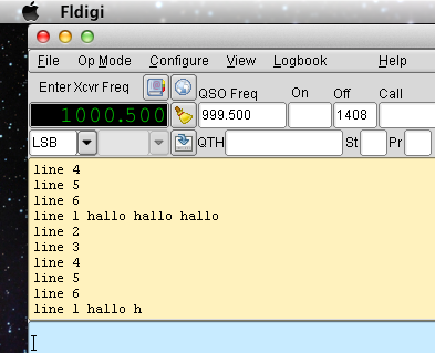

Uhm, it could be only a cosmetic issue.
What actually happen:
The RUMlog digi window shows the data being sent correctly, the cocoaModem shows it as one-liner (see attached screenshot).
Which is telling the truth ?

Re: Digi / PSK macro issue
:o Opps! :o
This seems to be a cosmetic issue in cocoaModem. My tests show, this happens in PSK only, in RTTY are all the printings correct. I started fldigi in parallel and the decoded transmitted audio show correct.
