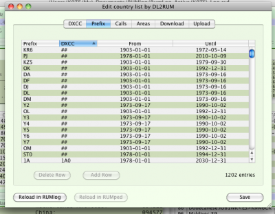

Jim K9TF

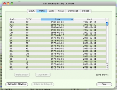

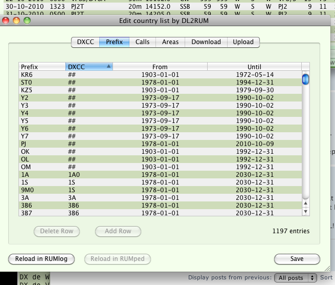

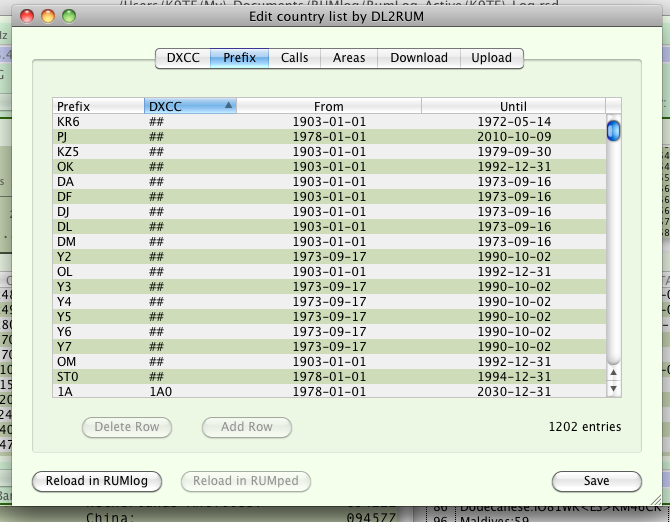

What Are deleted then?
Jim K9TF

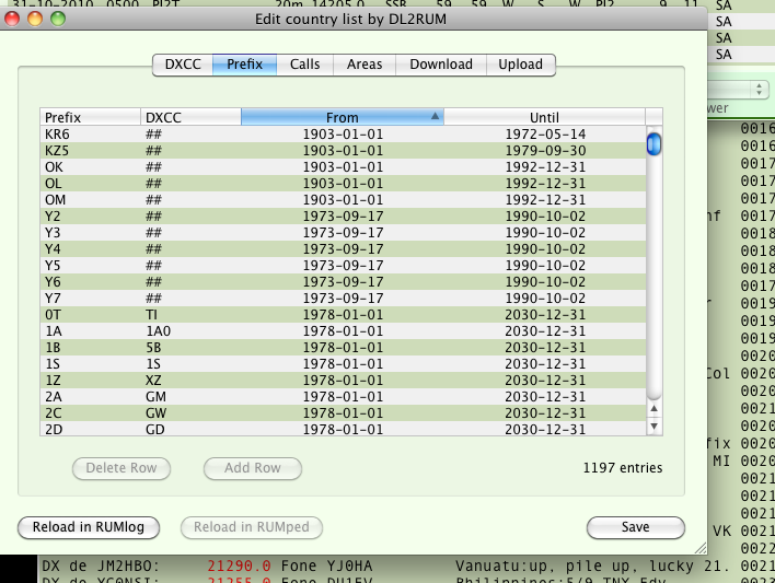

This is how it stands to make my ARRL DXCC Challenge totals to be in sync.
Jim K9TF
