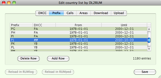

Under the "Prefix" tab delete all PJ1-PJ9 entries and add a new Prefix just called "PJ" and enter the following data:
The '"##" will mark all callsigns starting with PJ as invalid before 10-Oct-2010.

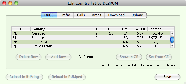

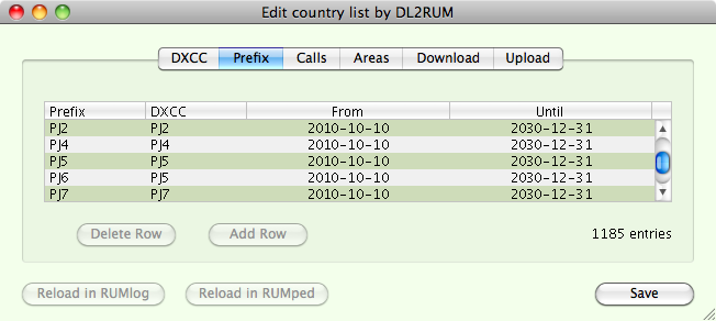

Adding the new entities
Under the DXCC tab add following rows:
Under the Prefix tab enter following rows:
When you have logged the new DXCCs already, you have to recalculate your log:
