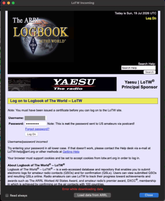

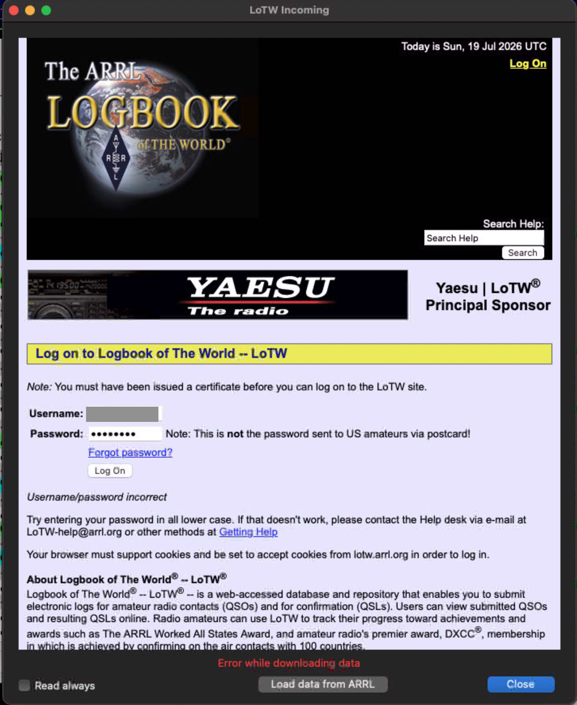

When I select QSL → LoTW Incoming → Load data from ARRL, the embedded LoTW login page is displayed.
Even after entering the correct LoTW username and password, it always reports:
Username/password incorrect
followed by:
Error while downloading data

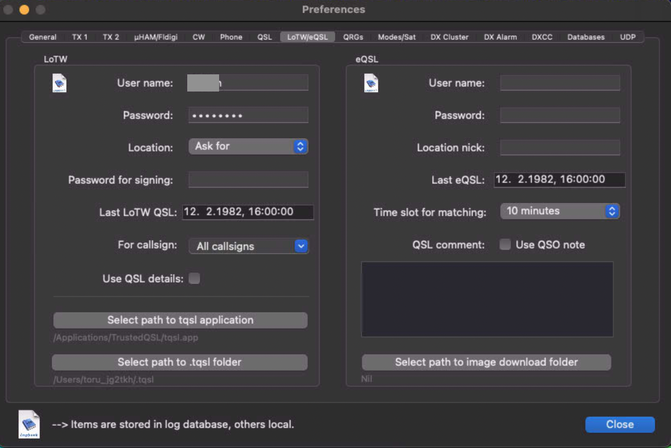

  • "Last LoTW QSL" remains at 12 Feb 1982 and is never updated.
Since LoTW upload works and manual download from the website also works, it appears that only the authentication used by LoTW Incoming is failing.

Do not interact with the displayed LoTW login page! This page is displayed just to see the error message.

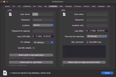

In the RUMlog LoTW settings select explicit your callsign in the For Callsign field.
Toru Mori
Joined: Sun 19. Jul 2026, 05:02
Re: LoTW Incoming authentication fails although LoTW website login works (RUMlogNG 6.5, macOS Sequoia)
Unread post by Toru Mori »
Thank you for your quick reply.
I changed the For callsign field from "All callsigns" to JK1AKC and restarted RUMlogNG.
Unfortunately, the behavior is unchanged.

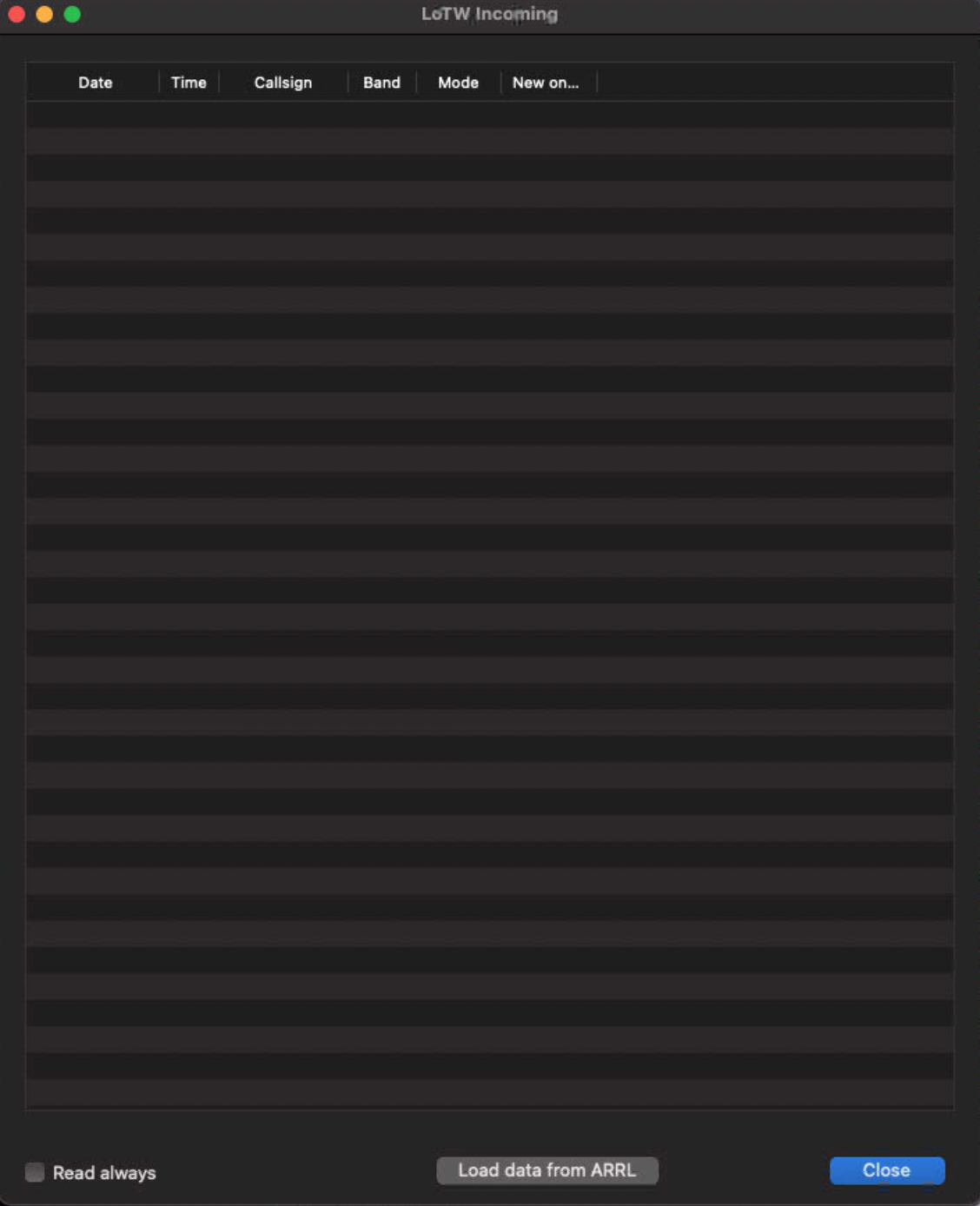

The LoTW Incoming list remains empty.
Clicking Load data from ARRL still displays the LoTW login page.
As you suggested, I do not interact with the displayed login page.

The cause was that different LoTW passwords had been stored in my RUMlogNG logbooks, although I believed that I had entered the same password in each one.
Tom checked the logbook files and found that the stored passwords were actually different.
I then changed my LoTW password on the LoTW website and copied and pasted the new password into both RUMlogNG logbooks.
