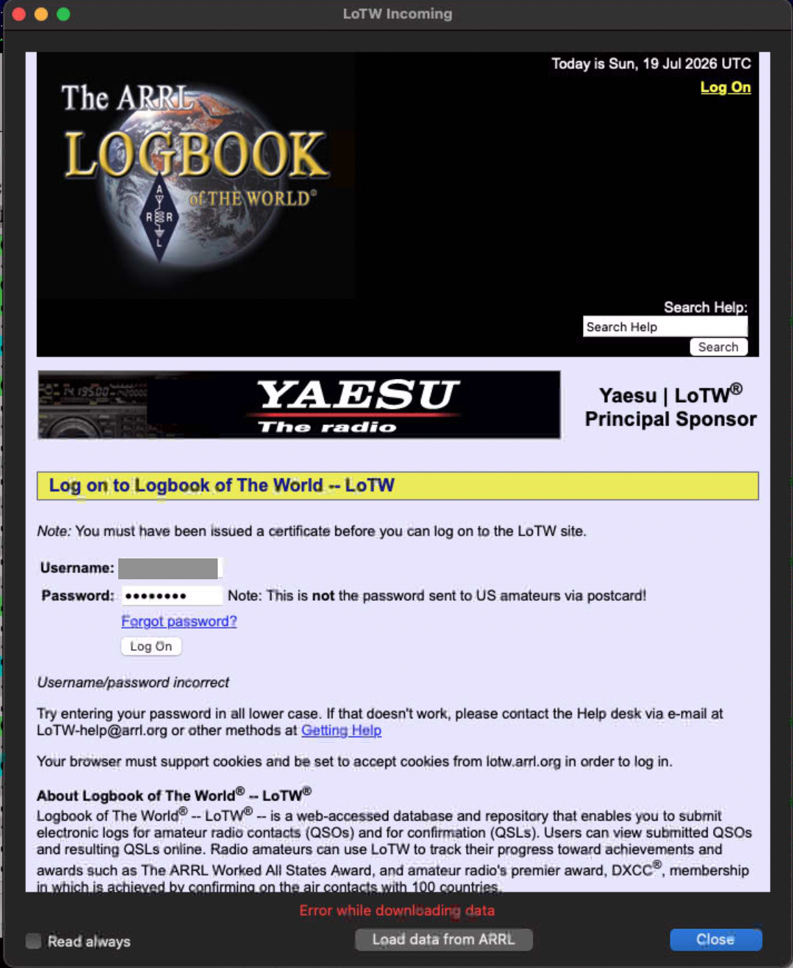

When I select QSL → LoTW Incoming → Load data from ARRL, the embedded LoTW login page is displayed.
Even after entering the correct LoTW username and password, it always reports:
Username/password incorrect
followed by:
Error while downloading data

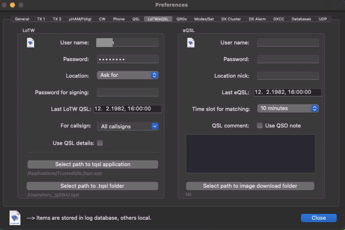

Since LoTW upload works and manual download from the website also works, it appears that only the authentication used by LoTW Incoming is failing.

Do not interact with the displayed LoTW login page! This page is displayed just to see the error message.
In the RUMlog LoTW settings select explicit your callsign in the For Callsign field.

Thank you for your quick reply.
I changed the For callsign field from "All callsigns" to JK1AKC and restarted RUMlogNG.
Unfortunately, the behavior is unchanged.

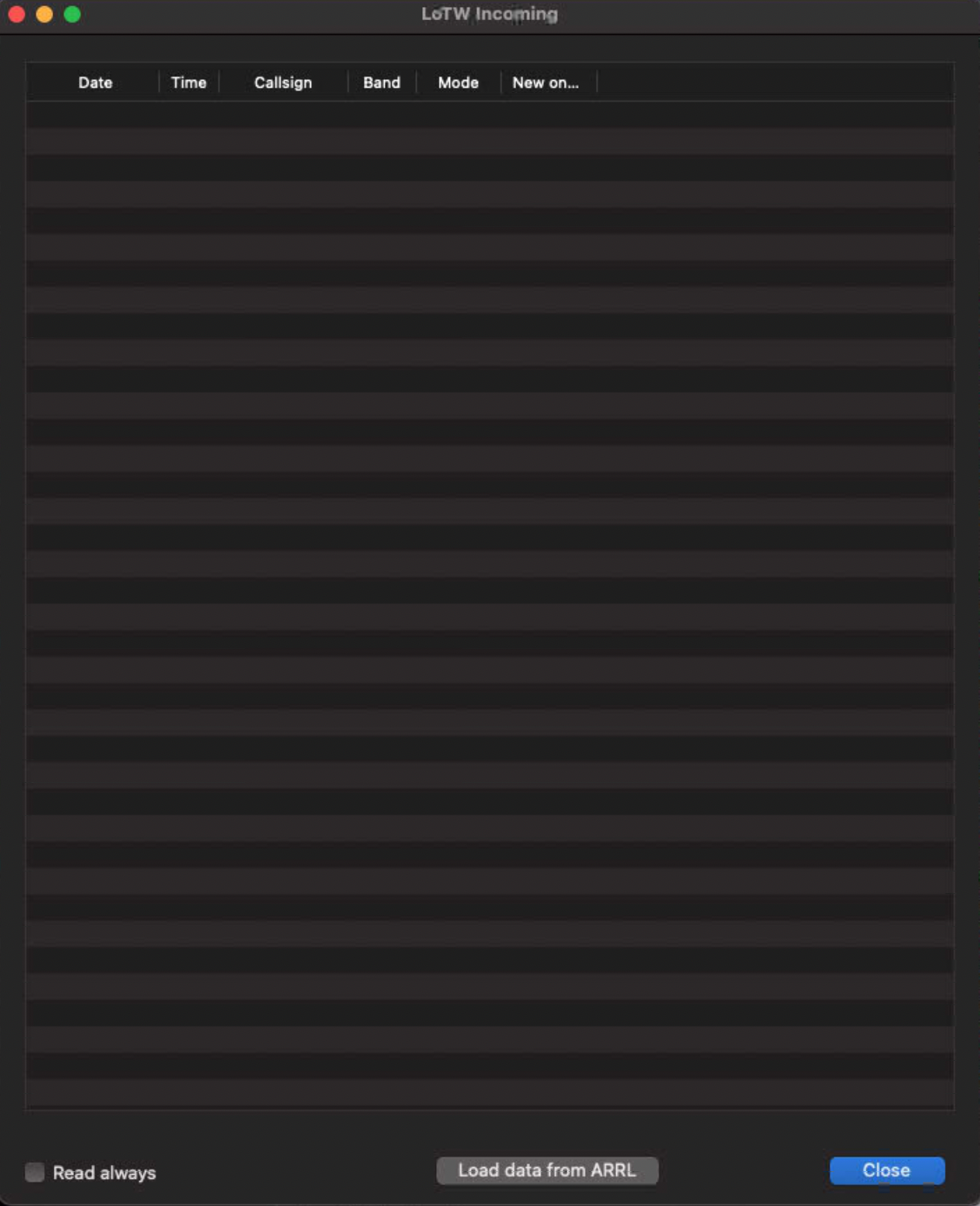

The LoTW Incoming list remains empty.
Clicking Load data from ARRL still displays the LoTW login page.
As you suggested, I do not interact with the displayed login page.
