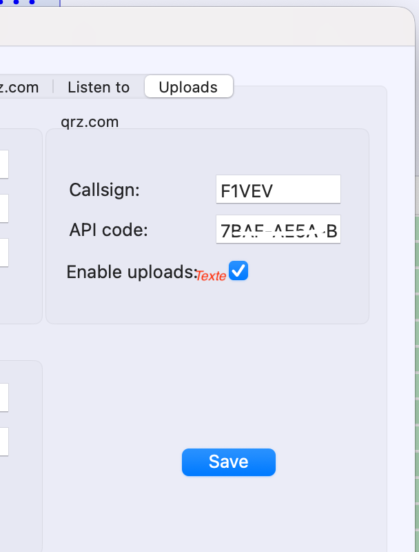

Hi are you sure that in QSO Upload you have under QRZ you have entered both your Call and API Key correctly ? Cheers

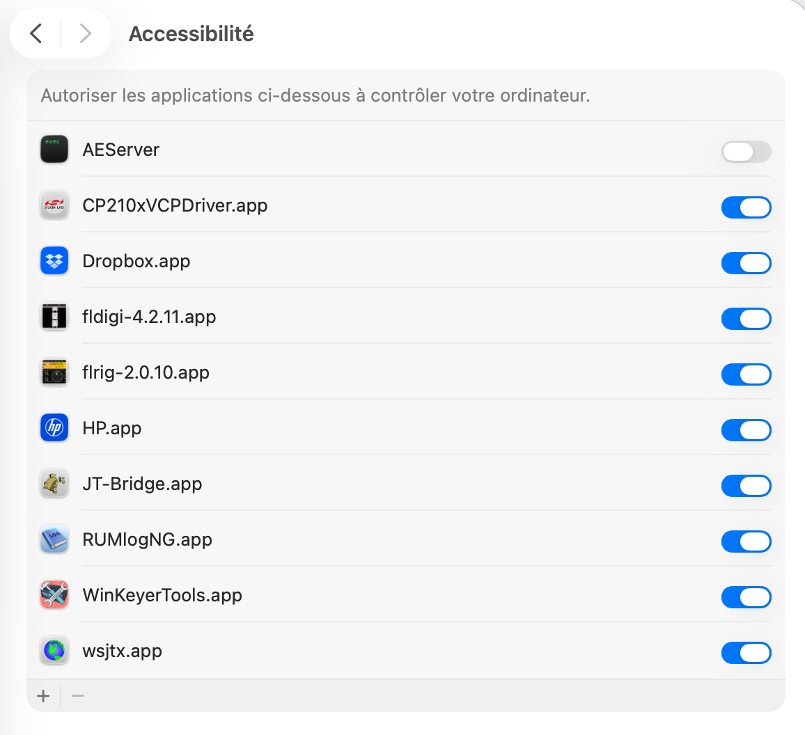

You can check following
Mac Acess

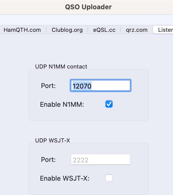

and UPD for qsouploader
this works great for me

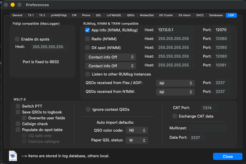

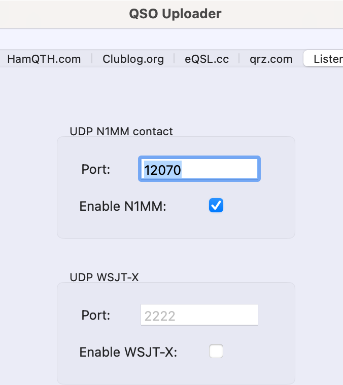

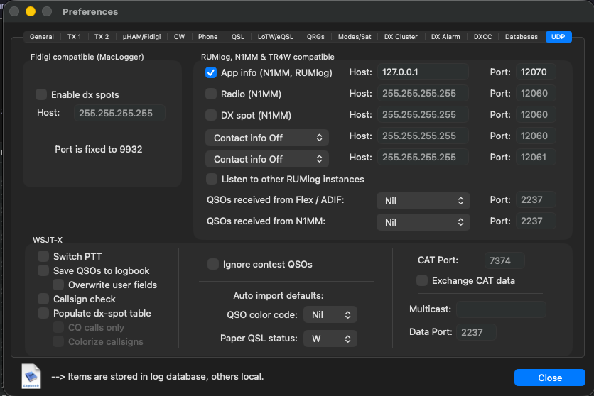

Unfortunately it's still not working. Here are the settings

Re: Issues with QSO upload and details fill.
What are your intentions? When you want to upload QSOs logged from RUMlog you have to enable the appropriate options.
See the Help for the upload utility.

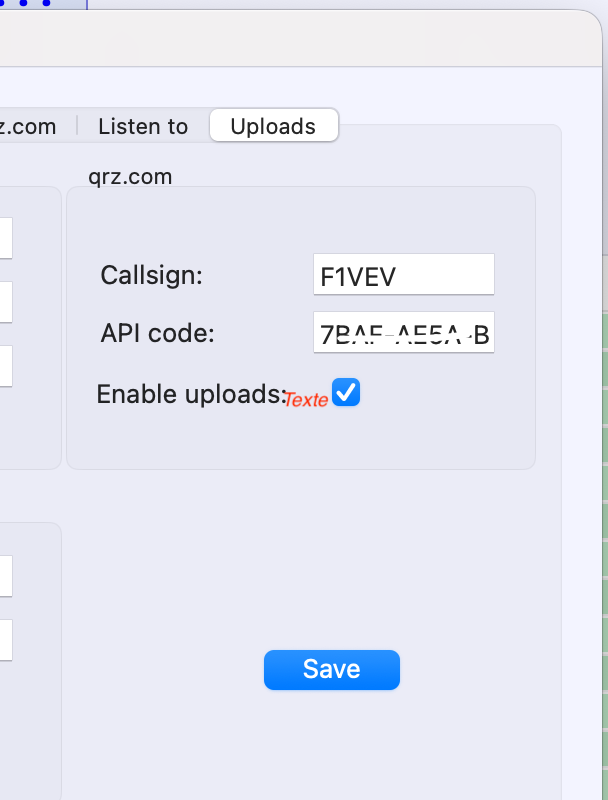

HI see difference in your first post between yours and mine
