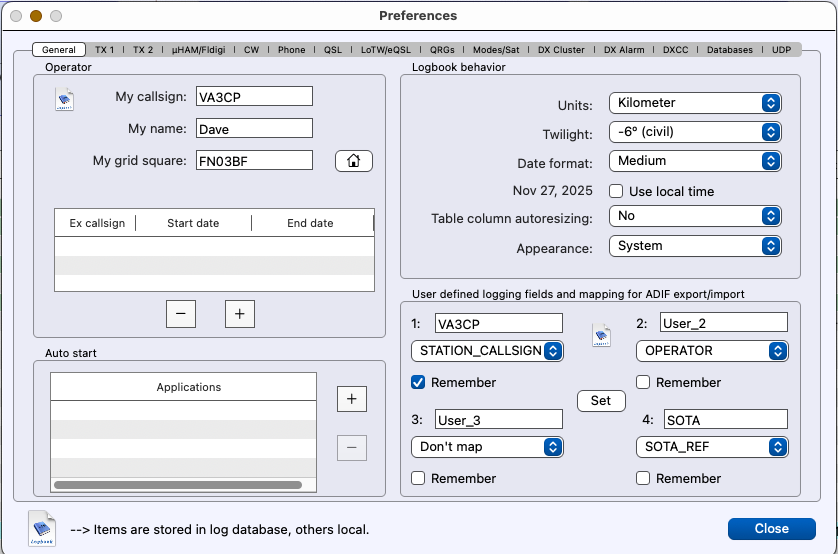

When I start RumlogNG, the main logging window seems to default to full screen. I have to make it smaller every time I start RunlogNG v5.19.5
Running macOS Sequoia 15.7.2
27" 2020 Intel Imac.
Rumlog is running on a 24" second screen in 1080p mode
