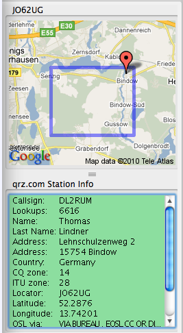

I have made an option using the qrz.com xml logger interface. You will need the subscription to get all data. (http://www.qrz.com/i/subscriptions.html) Enter your qrz.com login data in the RUMlog preferences under the QRZ/Map tap.
The new xml interface allows to read more data and the map is back again. Further you can click now on a dataset to take it over into the logging fields:
  • Name
  • ITU-Zone
  • CW-Zone
  • County
  • State
  • IOTA
  • QSL Manager
  • Locator
  • e-mail - opens Mail
  • URL - opens in your web browser
There is no auto transfer yet! Any thoughts?
When you delete your login data, you will get back the known table view, but no map.
Feedback is welcome.
