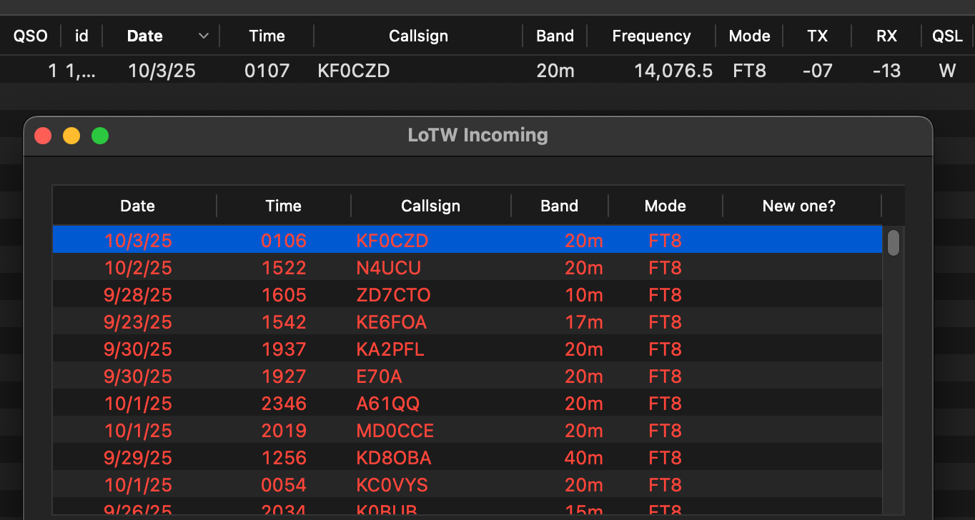

I have LOTW set up, and when I download QSLs, it seems to mark things as "X" for most entries. But for FT8 contacts that are not within the same minute, it seems to think these are separate contacts and lists them as not being in the log. My impression was that there was a 30min window for logging contacts with LOTW, but it seems like RUMlogNG sees these entries as separate? (From what I can tell, all FT8 contacts logged within the same minute are marked properly.)
I've started manually updating them as "X" when they come in. Do I have something configured incorrectly? Any better way of handling this?

I figured out how to adjust the last QSO date in the settings to get it to download them all again - here's what I see in red with the FT8 QSOs. I've attached a screenshot. (I hope it works - first time trying on this server)

I've gone through and updated the records in RUMlogNG, and when I set back the last imported date in the preferences and re-run the import command, it does seem to match up with the records as expected. So it seems like it's matching down to the minute. Most were off by exactly one minute, with my record being behind what I received from LoTW, and some were off by as much as two minutes.
For extra context, I import my FT8 logs from the ADIF file that WSJT-x generates, and my system clock is set via apple's servers. I've never had an issue making FT8 contacts with offset times. I wonder if FT8 logs the end of the QSO as the time, or if it logs when you actually click the button to save the log. My guess is the latter, which would explain why I'm sometimes off by as much as two minutes.
Shouldn't RUMlogNG match QSOs as +-15min, like LoTW does? Is there a particular reason it's matching to the minute? Now that I understand what's happening I can work around it, but it does seem like it should work slightly differently?

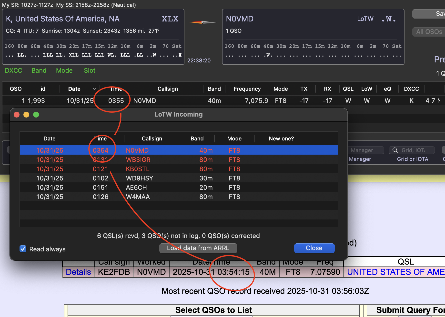

Unfortunately, it looks like I'm still getting syncing issues... Even with logs automatically being added to RUMlogNG via UDP, the LoTW records coming back are out of sync for some of them. It looks like they're anywhere from 30 seconds to a minute off.
I'm out of ideas for what I could change - the time on everything seems to be in sync on my end?
