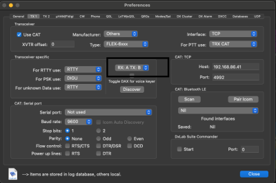

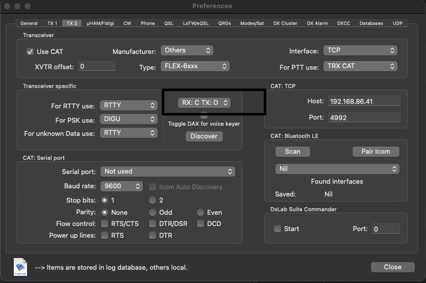

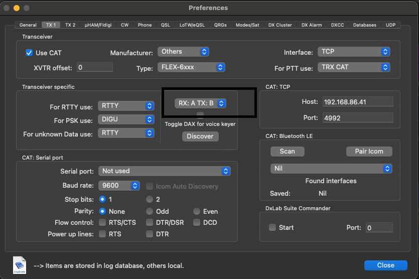

Thanks for the reply, I tried to configure RumLogNG to use same IP address and Port 4992 of FlexRadio as Trx# 2.

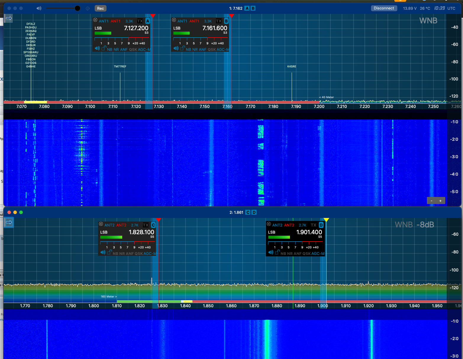

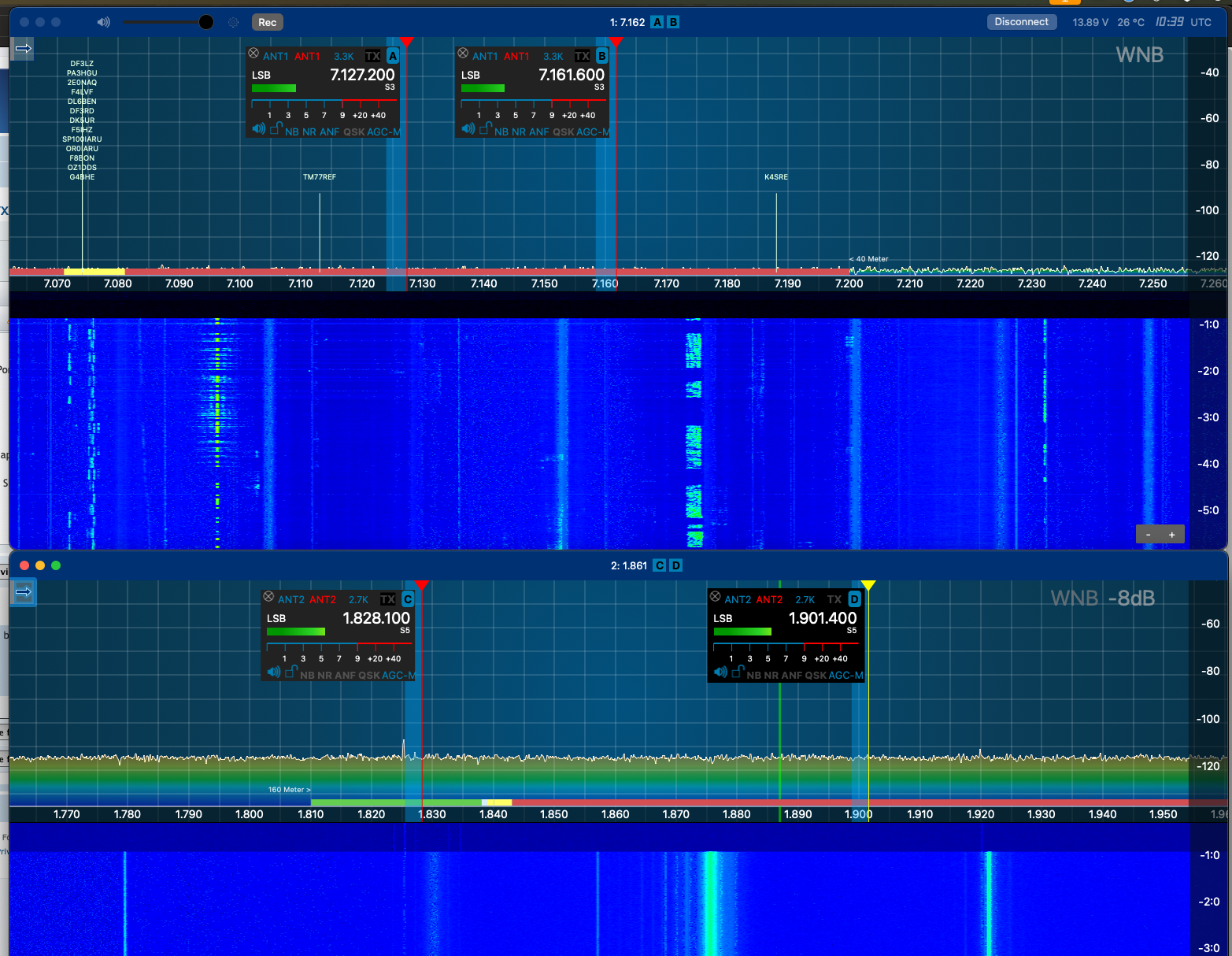

As you see the Flexradio configuration I have to always use the split mode in each pan adaptor which is not realistic in a day to day operation.
Most of the time the there will be one slice per pan adaptor and the Flex will name it as Slice A binding to the PanAdaptor -1 Slice B binding to the PanAdaptor 2.
Appreciate if you could provide another option Rx-A Tx-A and Rx-B- Tx-B in the Tx-1 and Tx-2 configuration page so that the 2 PanAdaptors of Flex 66xx can be treated as 2 different transceivers .
