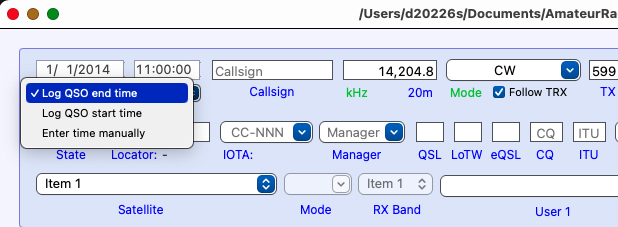

I saw that in the manual, but mine does not have it. Instead, it has a selector for "Log QSO end time" / "Log QSO start time" / "Enter time manually".
Eric

There is no "real time" checkbox under the date and time boxes.
You use Real Time, when you don't have selected Enter time manually.
