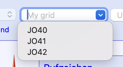

Are you talking about your own presets in the combobox popup menu?
Then you are right. These values are stored locally. It could be make more sense to save it in the logbook file.
