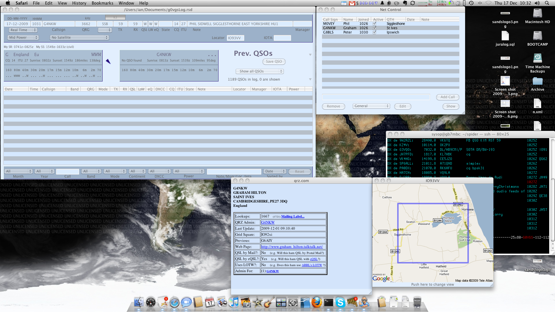

I logged a station this morning and the QRZ information came up, along with a map. The next station changed the information but not the map even though (as you can see in the screenshot) the locator was included from QRZ. I have noticed this before.

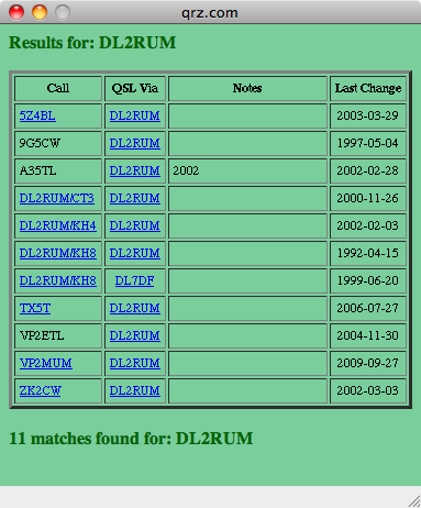

Also what does the 3rd QRZ window do? I understand the map and the info windows but the other one always seems blank for me.

neither, nor ....
It's an user error. :mrgreen:
You can toggle the options, check your settings:
  • Menu-->QSO-->Auto qrz.com Lookup - shows station info
  • Menu-->Maps-->Auto Station in Google Maps - shows the map
BUT, there is a known error. Sometimes, these internet based contents are not rendered correct. This is out of my control.
The 3rd window is used for QSL information.
  • Menu-->QSL-->qrz.com QSL Lookup - starts the lookup manually
  • Menu-->QSL-->Auto qrz.com QSL Lookup- starts the lookup automatically
