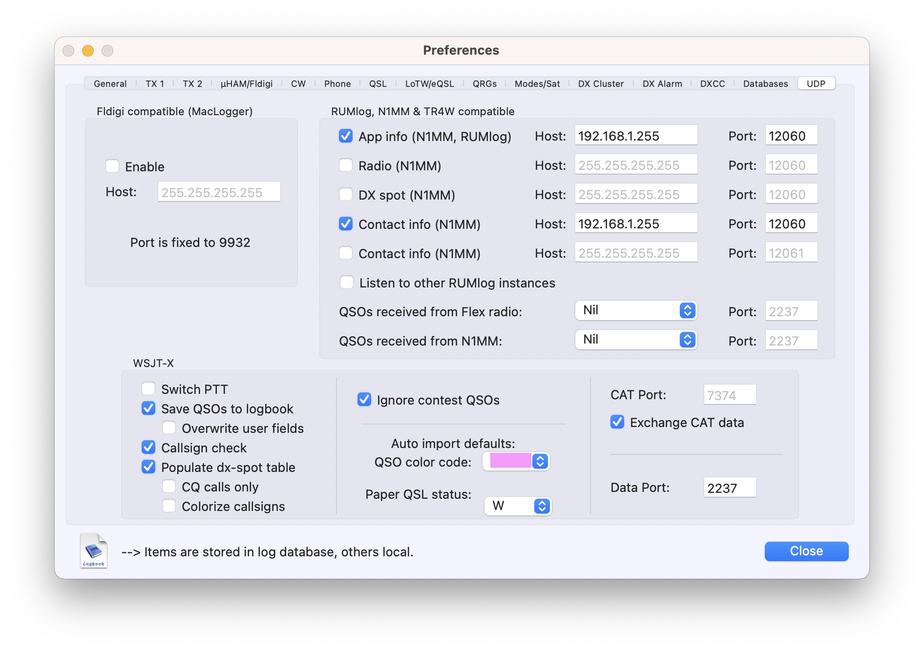

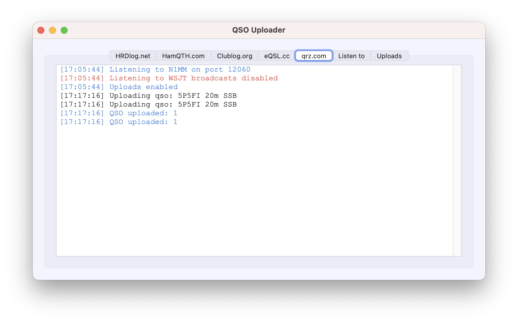

It seems that my QSO are all uploaded doubled... Where am I doing wrong. It also applies for HRD log, club log ecc... Thanks!

Check your network UDP broadcast settings.

But i have seen this before, when you are connected twice. Via LAN and via WLAN.

It is very much possible on the iMac. As you may know, disabling WiFi is going to stop Airdrop and maybe other things from working... Do you have a suggestion?

Pull the plug. Or try localhost instead of broadcast it to the whole network.

Thanks, it worked! But I'd think in adding interface selection in preferences ;)
