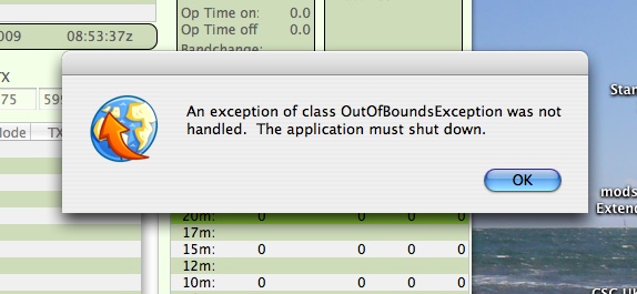

I am using RUMped 2.0 Beta 30, when in BPSK mode, if I select "Narrow Low" using the embedded waterfall display, I get the following exception pop up;
An exception of class OutOfBoundsException was not handled. The application must shut down.
This problem is repeatable on my system, and only occurs if I choose "Narrow Low". Using normal wide or "Narrow High" all is OK.

Capture of the popup

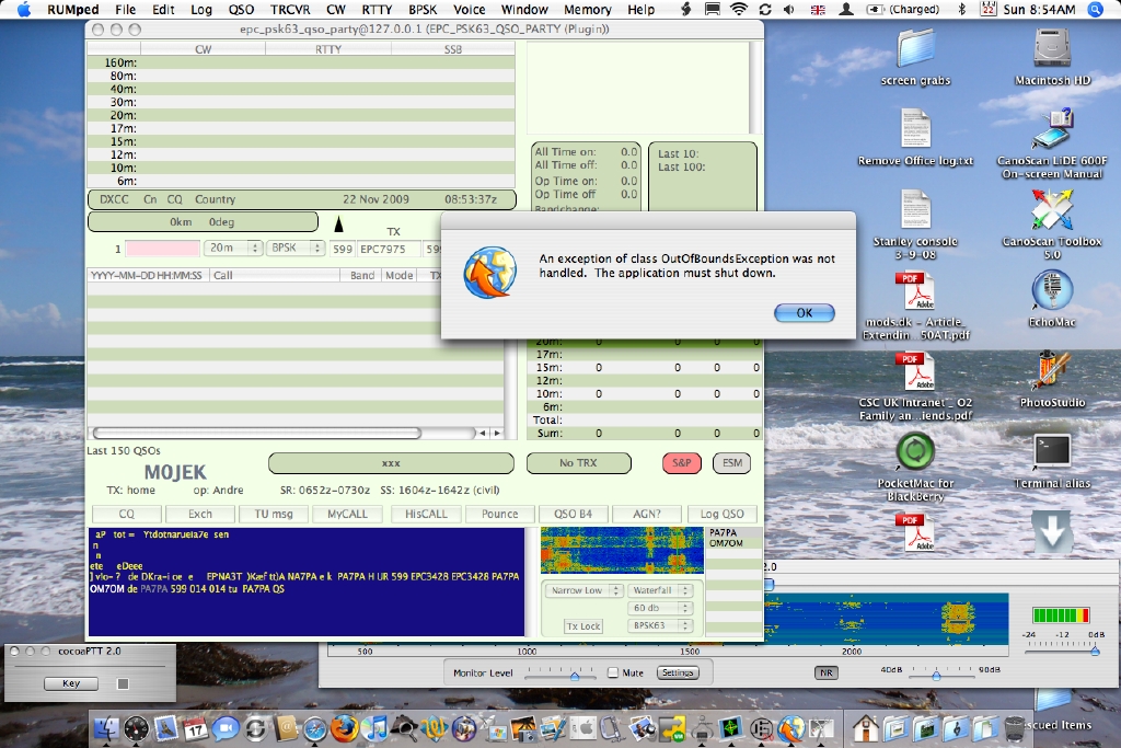

I can't duplicate the failure here. Please send a screen shot, where I can see the other PSK settings. Do you use the the cocoaModem Lite Interface?

Yes I am using the cocoaModem Lite setting. I have including a full screen shot. I hope it shows enough. The mode in use was BPSK63, and it was very busy. Might that have had an influence? I am running an old 1.67 GHz PowerBook G4 :-)
Full screen shot (scaled)

Hmm, I 'm still unable to reproduce that. It happens only when selecting Narrow Low? All other possible selections are working fine? Can you try RTTY mode?
