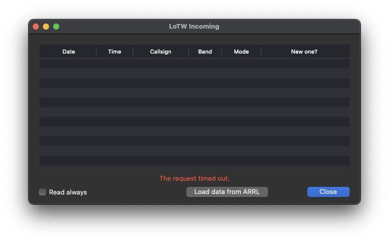

However now I run into a timeout downloading the data from ARRL. After some time the dialog gives a "The request timed out" message. When downloading the report from the ARRL website using a browser it also takes considerable amount of time, however the download is successful.
Perhaps the time-out can be increased in a future version, or an option to import the manually downloaded report could be added? RumLog2Go gives the same "time out" error.
