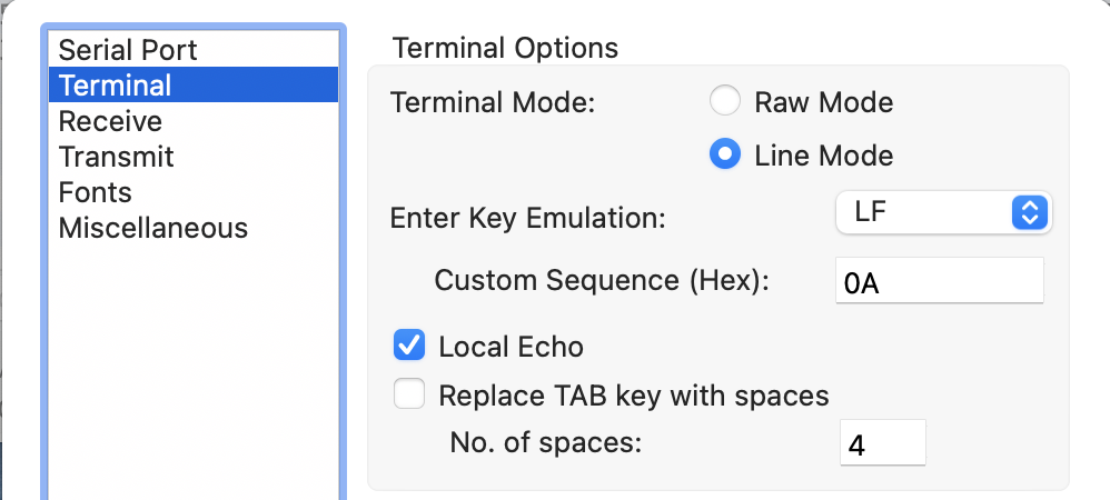

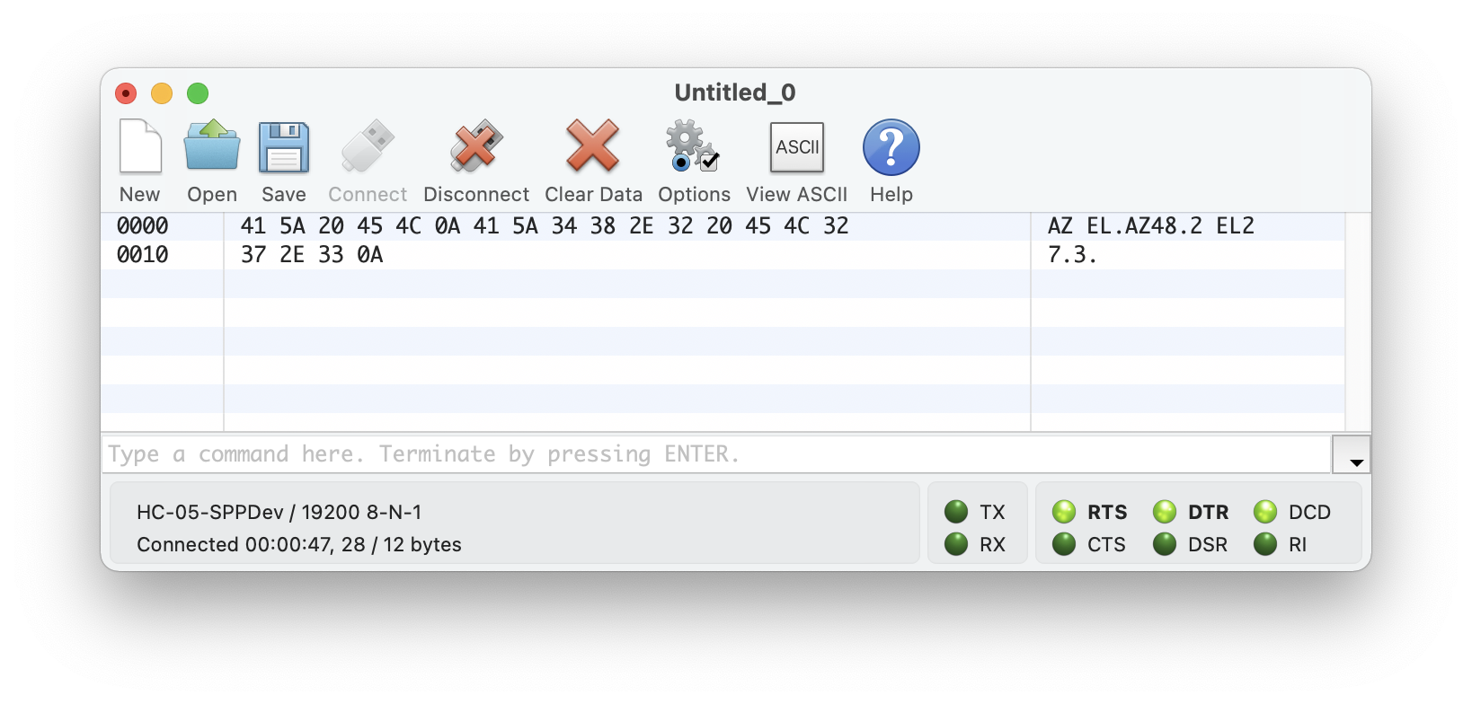

Re: Latest Rotor 1.1.2 (53)
Since I use this controller as well, I'm sure it should work.
Can you provide similar screen shots? I've just sent AZ EL 0x0A The return was AZ0.2 EL-0.3 and AZ48.2 EL27.3 The answer must be terminated by a 0x0A
Klaus

Tom, the problem is not the serial terminal, when I send AZ EL 0xA I get the current position, like AZ 90.2 EL 10.3, as expected.
The problem is, when I use your rotor program (rotor control window) and turn horizontal direction or grid to 90 deg, then the rotator turns to the desired position, but the display (Azimuth) stays at 0 deg.
73 Klaus
We have to confirm:
  • There is no space between AZ/EL and the value
  • There must be a 0x0A as terminator
Only when the format is correct, the Rotor app can read the values.
Klaus
