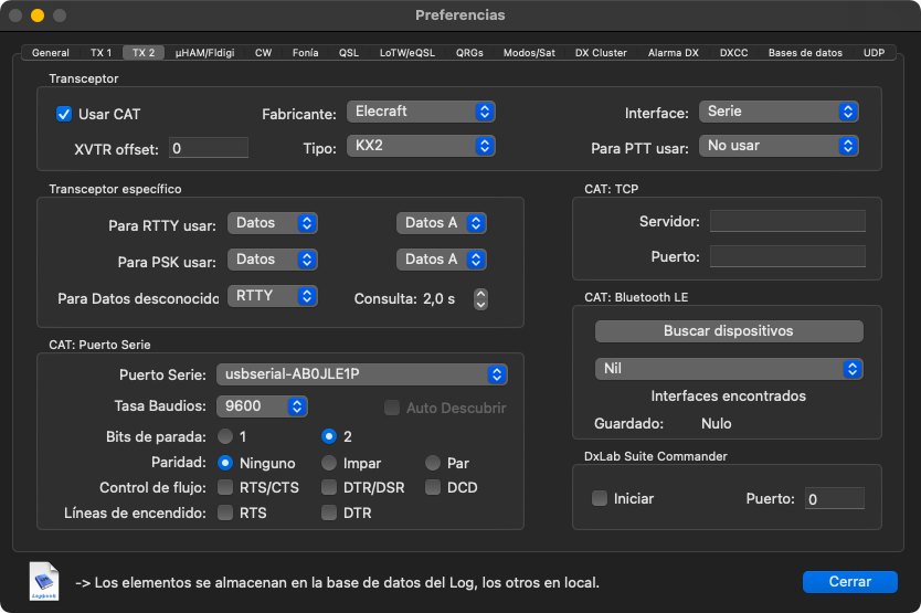

Dear all
Sorry for posting this stupid question.
I am trying to control my KX2 via RUMlogNG and read the operating fx and so on and eventually use the Transceiver Ctrl provided.
I am trying to do so using the provided KXUSB cable but I am unable to find the right settings in the preferences menu for TRX#2.
The serial port is found and the cable works as I have been able to update the firmware of the KX2 with elecraft's app.
Is this control possible with the KXUSB cable?
What are the serial bus settings?
Running here latest version of RUMlogNG, OSX and KX2 firmware.
Thank you and sorry for the stupid question.
Stefan

It should work. The baud rate is set correct? Do you have connected another trx as #1?

I have at TRX#1 an IC7300, but disabled and the USB unplugged.
The baud rate is set to the one I use also for my IC7300. I will try to increase it to what the Elecraft app says (38400).
I have set the Baudrate to 38400 and now it works, Tom. But I promise that I did try it already before. It was probably a question switching on and off everything and start it over again.
