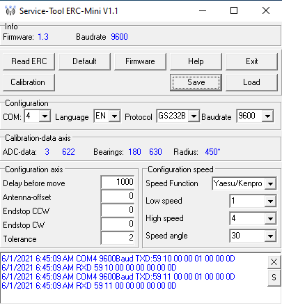

I've managed to make it working with the ERC Mini with the G-800DXA.
For other users of the ERC Mini, make sure you calibrate the ERC Mini interface and double check the Calibration-data axis the following parameters:
ADC-Data: should have values different from zero. As shown in the picture.
I confirm the Rotor application works with this setup.
Fernando.
