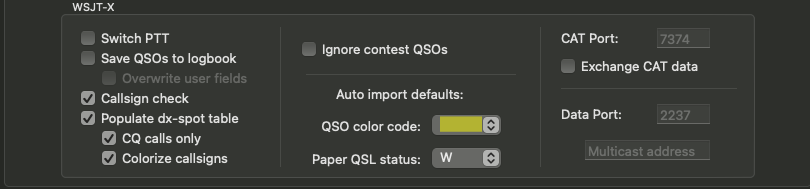

I believe this is what you are referencing
I turned off "Prompt me to log QSO" in WSJT-X
I turned off "Save QSOs to Logbook" in RumLogNG
I turned on "Callsign Check in RumLogNG"
It worked the first time. RumLogNG prompted me to save the QSO and had updated the TX/RX fields.
I tried again, and never got the RumLogNG notification to save QSO and the TX/RX fields were not updated.
