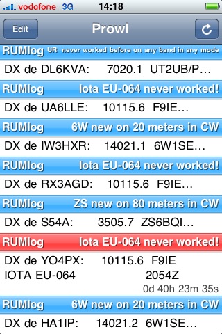

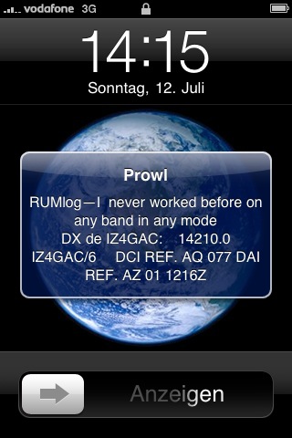

Prowl is a Growl client for the iPhone. Using Prowl, you get pushed DX Alerts from RUMlog within seconds direct to the iPhone. This service is free, only for the app you have to pay few bugs. No changes are required in RUMlog.

Hi ALL,
just installed this application and it's running very well. I use it to send DX-Cluster alerts from RUMLog to my iphone.
So an auto re-connect functionality in RUMLog's dxcluster client would be very much appreciated as our ISP reconnects and renews the IP number roughly every 24h.

Is there a way to have the notifications include the frequency in the text of the alert? This would also be useful for the regular style alerts.
NY6W
Posts: 3108
Re: Pushing DX Alerts to your iPhone
I could add it again, but why do you need it?
