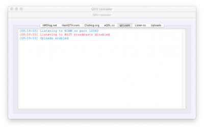

Since I installed Rumlog version 5, the QSO upload utility stopped working.
In the utility window, it connects to the different sites without apparent error but then, the uploaded QSOs do not appear in the window utility and in the sites (QRZ, HRDlog and HamQTH). The rest of the sites (Clublog and eQSL) I have deactivated, the same Rumlog does.
Does anyone have the same problem or any idea?

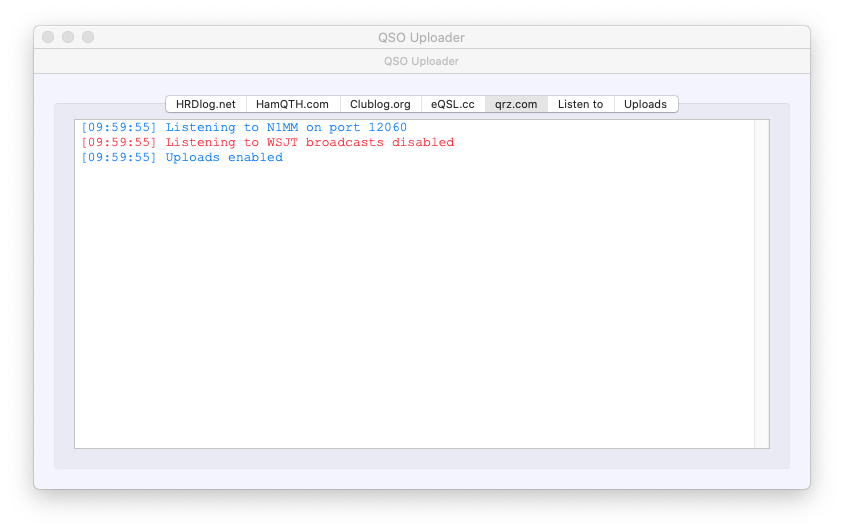

Re: QSO Upload Utility not working
You should post a screen shot of the qrq.com tab. What is it showing?
Unread post by James »
Thomas, says nothing.
The other 2 include the uploads.
It stopped working, just upgrade RumlogNG to V5.
I don't know if it's a coincidence.
No other software upgrade on i Mac for several weeks.
