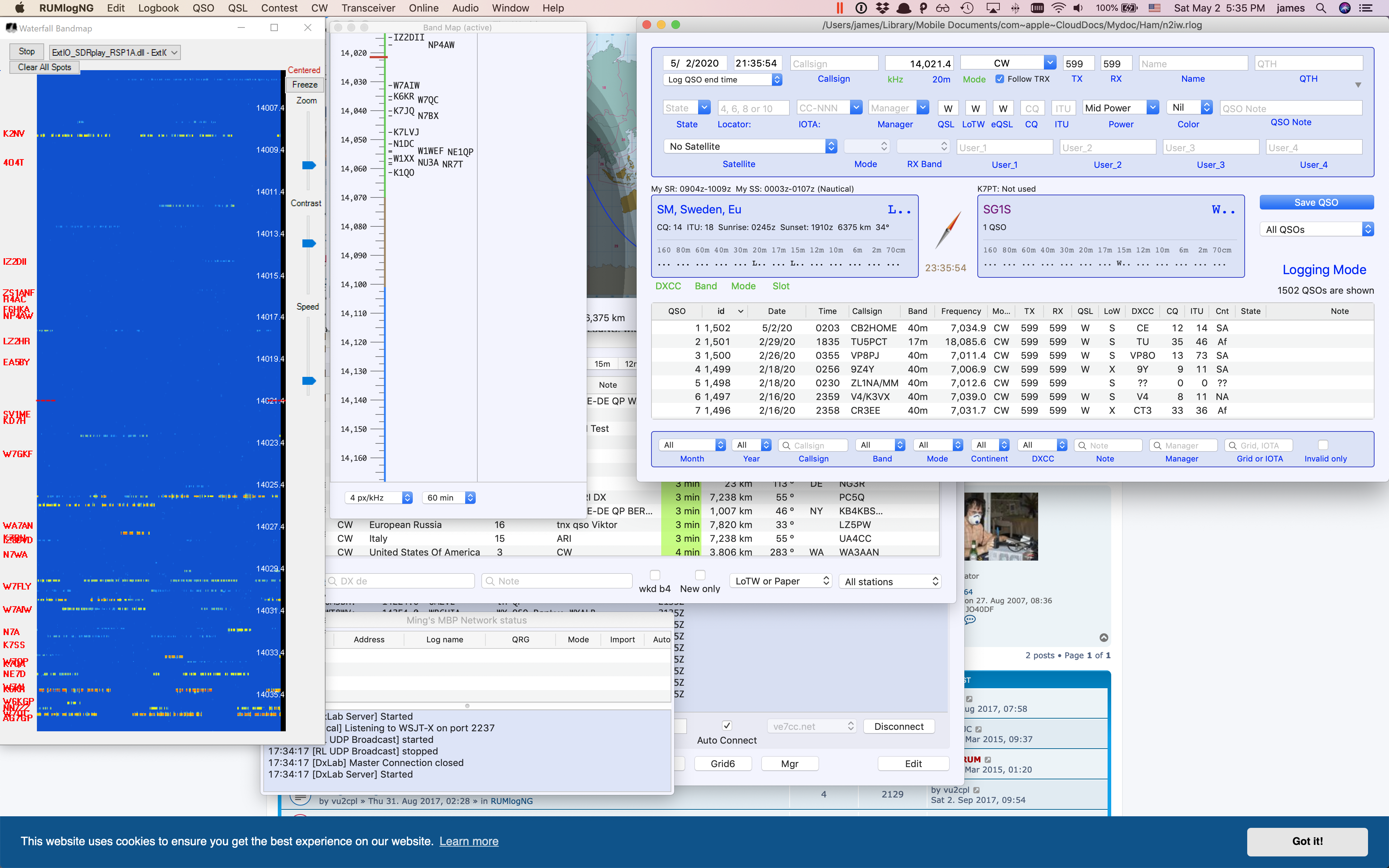

Thanks so much for the quick reply Tom! Information for waterfall bandmap can be found at https://groups.io/g/waterfallbandmap/topics A lot of contesters use it with N1MM logging app. As you can see in the attachment, the waterfall bandmap can display a waterfall from SDR and put spots on it also, so you can see if you can really hear a station in the spot. Also what stations have not been spotted. It's really useful for me as a DXer.

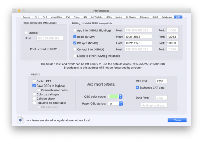

The bandmap needs N1MM or RumlogNG in my case to send spots information as well as radio information to port 13063. My Parallels Desktop VM runs on internal IP 10.211.55.3. You can see how I set it in RumLogNG to make it work with Waterfall Bandmap. If you can make RumLogNG send radio info every 100Hz, that probably will be good enough! Another thing is, the spots N1MM sent out have different colors, to differentiate between country/band etc. If RumLogNG can do similar thing, that would be even better!
