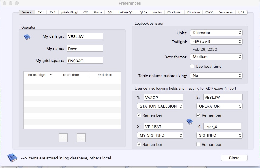

I am running RUMlogNG v3.12.2 and under Preferences>General, I have configured the user defined logging fields 1, 2 and 3.

Do you have entered these data in to the logging fields? I'm wondering about your entered data in the Preferences. There you have to enter a header text for the QSO table, not your data.

What I was trying to do was have User_1 to User_3 set permanently to specific values and add User_4 info when appropriate. For this VE3LJW log, the STATION_CALLSIGN would always be VA3CP, the OPERATOR would always be VE3LJW, MY_SIG_INFO would be my POTA park number and SIG_INFO would be the POTA park number of the other station when working them Park-to-Park.
The way I understand it is that I have to type all four User_X fields in manually for each QSO.
When you have checked the option Remember, you have to enter the value just once. Always the data from the previous entered QSO will be used.

I have tested what you say and it works fine. I did not understand the way to use those four fields.
Now, the .adif export includes those four fields.
