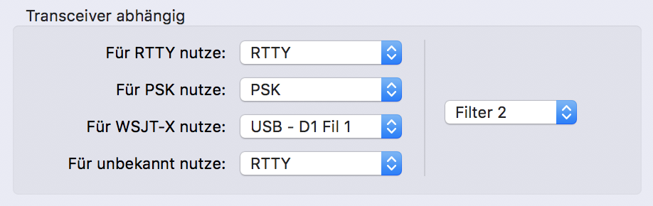

I have one other query. When using WSJT-X along side Rumlog (linked via UDP), I find that the rig is always put into USB mode on each over. On the 7610, we have a digital USB mode which is great for bypassing audio filters and keeping the microphone on mute. Is the signal to change to 'normal' USB coming from Rumlog or from WSJT? I haven't been able to keep it in the digital mode despite fiddling with settings in both apps.
Michael

For control from WSJT-X RUMlog uses the PSK mode setting from Preferences-->TRX
IC7610 only: The latest test version provides an extra setting for WSJT-X. You can select Data 1-3 only, the filter is fixes to FIL 1.
Separate WSJT-X setting is for the IC-7610 only!

Just following up: the new test build works perfectly, with the USD-D1 mode set exactly as expected.
I have had no problems to report.
