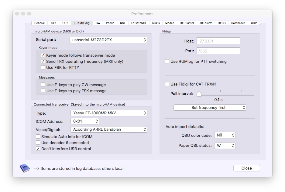

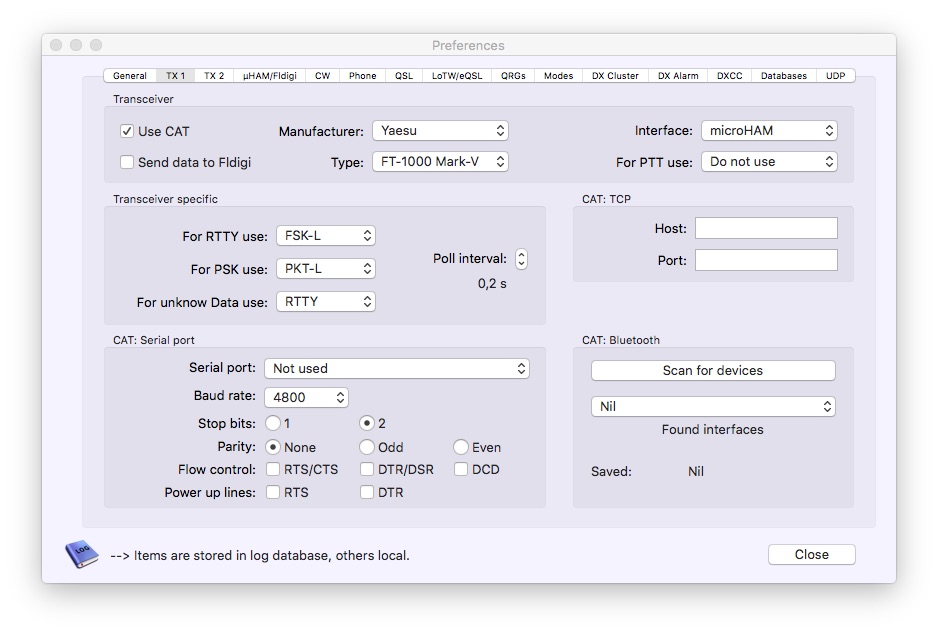

I am currently considering to switch to RUMLog since the microHAM MKII seems to be much better supported compared to my current logging program. The only issue is, that do not get it to work with my setup.
I am running a FT1000MP MARK-V with a microHAM MKII (FW 6.12) connected. The connection between RUMlogNG and the MKII seems to be OK, although I am not able to switch the MKII mode but the settings can be written and also the MKII is connected in the microHAM window.
Somehow the MKII seems not be connected to my FT1000MP MARK-V since when the VFO A Frequency is not visible in MKII display and of course not in RUMlogNG and the MKII is not following the mode of the MK1000MP MARK-V..
Maybe someone has a similar setup and may give a hint?
Below are my settings, maybe there is something wrong there?
Alex, DC1LEX

Thanks Tom for answering.
Which port settings do you mean? In RUMlog?
I posted the settings as pictures and those should be OK I think?
Posts: 2994
Re: FT1000MP MARK-V and MKII CAT Control
Yes. I don't know which settings the FT-1000 requires.

as a serial Interface the FT1000MP needs 4800,N,8,2 (4800 baud, no parity, 8Data bits, 2 Stop bits). But since the radio is connected to the mKII it should be handled by the mKII, right?
Alex, DC1LEX
Posts: 2994
The MKII is handling nothing! As soon it is connected to a host, it acts just a deaf CAT interface. It's all in the host software.
There may be a problem with the CAT interface in RUMlog.
1. Try to get CAT running without the MKII.
When this fails, I would like to connect to your trx remotely using this tool: http://dl2rum.de/RUMlogNG/TCP2Serial.zip
