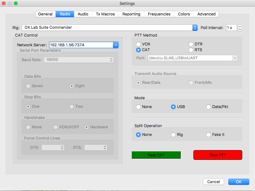

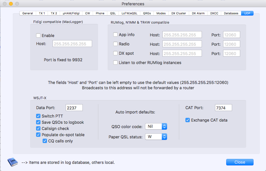

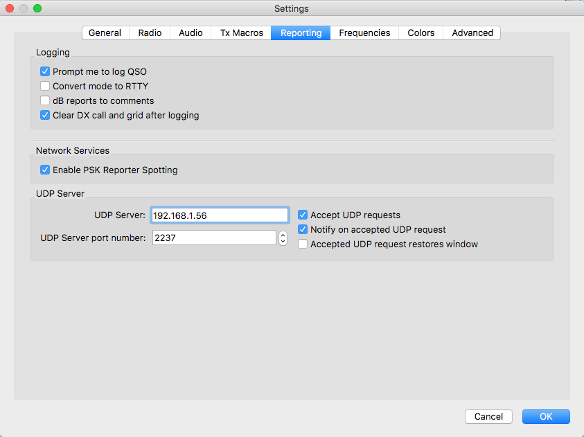

WSJT-X and RumlogNG on the same machine. I followed the instructions in the WSJT-X and RUMlog section of the help. IP address used for all settings is 127.0.0.1 as mentioned in the manual.
RUMlog sees the connection to the radio, but doesn't follow. I need to Reset Cat a few times for RUMlog to show the new frequency.
Switching bands in WSJT-X doesn't switch the radio.
Switched from using 127.0.0.1 to the real internal IP address in the 192.168 range. This solves the Follow TRX issue in RUMlog.
Switching bands in WSJT-X still doesn't switch bands on the radio. Test CAT and Test PTT in WSJT-X work as expected. When switching the bands manually using the radio both WSJT-X and RUMlog follow correctly.
How can i make sure WSJT-X is sending the band changes to RUMlog?

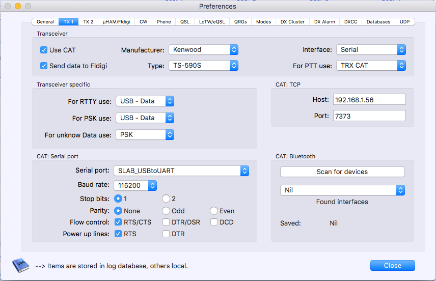

  1. You have to get CAT control from RUMlog working first - without Fldigi and without WSJT-X
  2. Changing ip addresses can not affect your serial CAT connection.
  3. ip addresses may change. You should use localhost or 127.0.0.1
  4. Why do you have set the Power up RTS line option? This may interfere your connection.
  5. You have selected two PTT options for WSJT. Deselect the PTT option in RL --> UDP --> WSJT-X or set in WSJT-X --> Radio --> PTT Method to None

DL2RUM wrote:You have to get CAT control from RUMlog working first - without Fldigi and without WSJT-X
CAT control works correctly in RUMlog.
DL2RUM wrote:Changing ip addresses can not affect your serial CAT connection.
I know. I find this strange as well. Maybe because i have A LOT of interfaces in my Mac.

DL2RUM wrote:ip addresses may change. You should use localhost or 127.0.0.1
I will follow your advice.
DL2RUM wrote:Why do you have set the Power up RTS line option? This may interfere your connection.
Unchecked. Don't see a difference.
DL2RUM wrote:You have selected two PTT options for WSJT. Deselect the PTT option in RL --> UDP --> WSJT-X or set in WSJT-X --> Radio --> PTT Method to None
There is no WSJT-X --> Radio --> PTT Method --> None so i did the first option.
All IP addresses set to 127.0.0.1 instead of 192.168.1.56. RUMlog follows the radio correctly. WSJT-X follows RUMlog correctly. :)
Radio doesn't follow the band change in WSJT-X.
