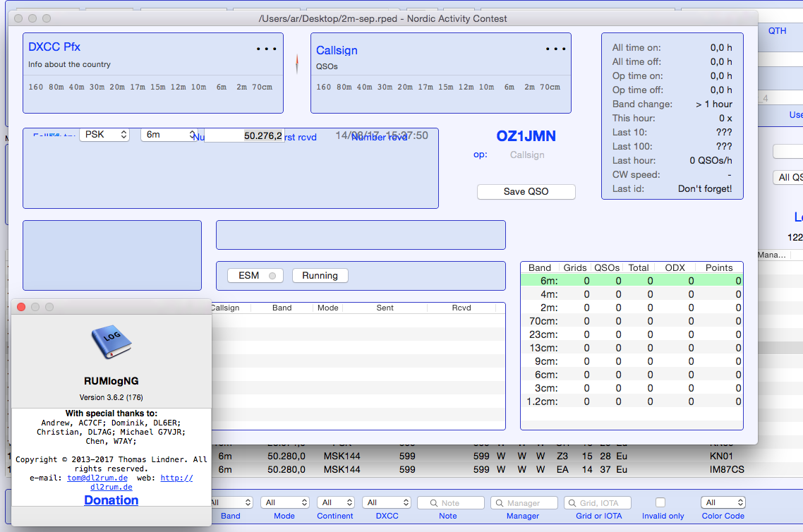

Hello
And tnx for a super program....
Just update to Version 3.6.2 (176) and try to start a new NAC or others contest
but no input field, se screendump
best 73 OZ1JMN Allan

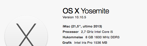

Re: Missing input field contest mode
Which macOS version do you use?
Unread post by golfine »
Tnx
Posts: 3104
It seems there is a problem under 10.10. Other users reported a similar issue.
When you can’t update your macOS system, you have to go back to RUMlog version 3.5. You can load it here: http://dl2rum.de/RUMlogNG/RUMlogNG_3_5_1.zip
