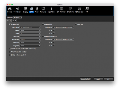

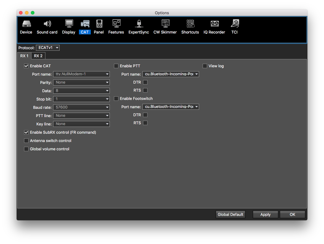

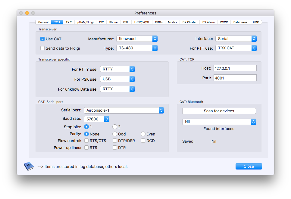

After many years with Mac as my primary work PC I am now playing with it in the shack too. I am trying to make it work with my SunSDR2 QRP transceiver using a virtual serial connection between the logger and the radio's control softare. It kinda works as I am able to update the logger with the tuned frequency by doing a reset of CAT, but RUMlog does not automatically follow the radio. In my setup I am using AirconsoleOSX to create a "virtual nullmodem cable". This setup works fine with MacLogger and fldigi, but not with RUMlog. The CAT protocol of SunSDR2 PRO is compatible TS-480. All ideas welcome!

RUMlog uses the AI2; (Auto Info) command to fetch trx data. Is this command implemented in your emulation?
SM0MDG
Posts: 8
Joined: Wed 19. Jul 2017, 21:58
Re: Virtual serial cable
Unread post by SM0MDG »
That seem to be the problem. The SDR software doesnt support the autoinfo command.
