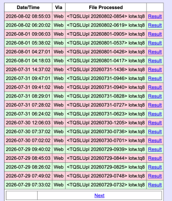

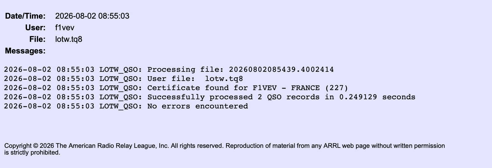

Re: LoTW download.
I would like to have the problem resolved. Of course, I can't rule out the possibility of an error in RL. However, I consider that rather unlikely.
Please check your activity report on the LoTW web site: https://lotw.arrl.org/lotwuser/account? ... d=activity
What do you see?
What do you see?
Re: LoTW download.
HI,
a spot check revealed taht there were no errors in LoTW activity report I will wait to have another issue and trace all parts i.e. RL upload and LoTW confirmation and activity report etc . and forward those to you
Thank You
Thank You
Best 73s Jacques F1VEV
Re: LoTW download.
I just want to see the full report from https://lotw.arrl.org/lotwuser/account? ... d=activity - not the result of a single upload.
Re: LoTW download.
This looks good. Do you have seen the problem again in the reported time frame?
